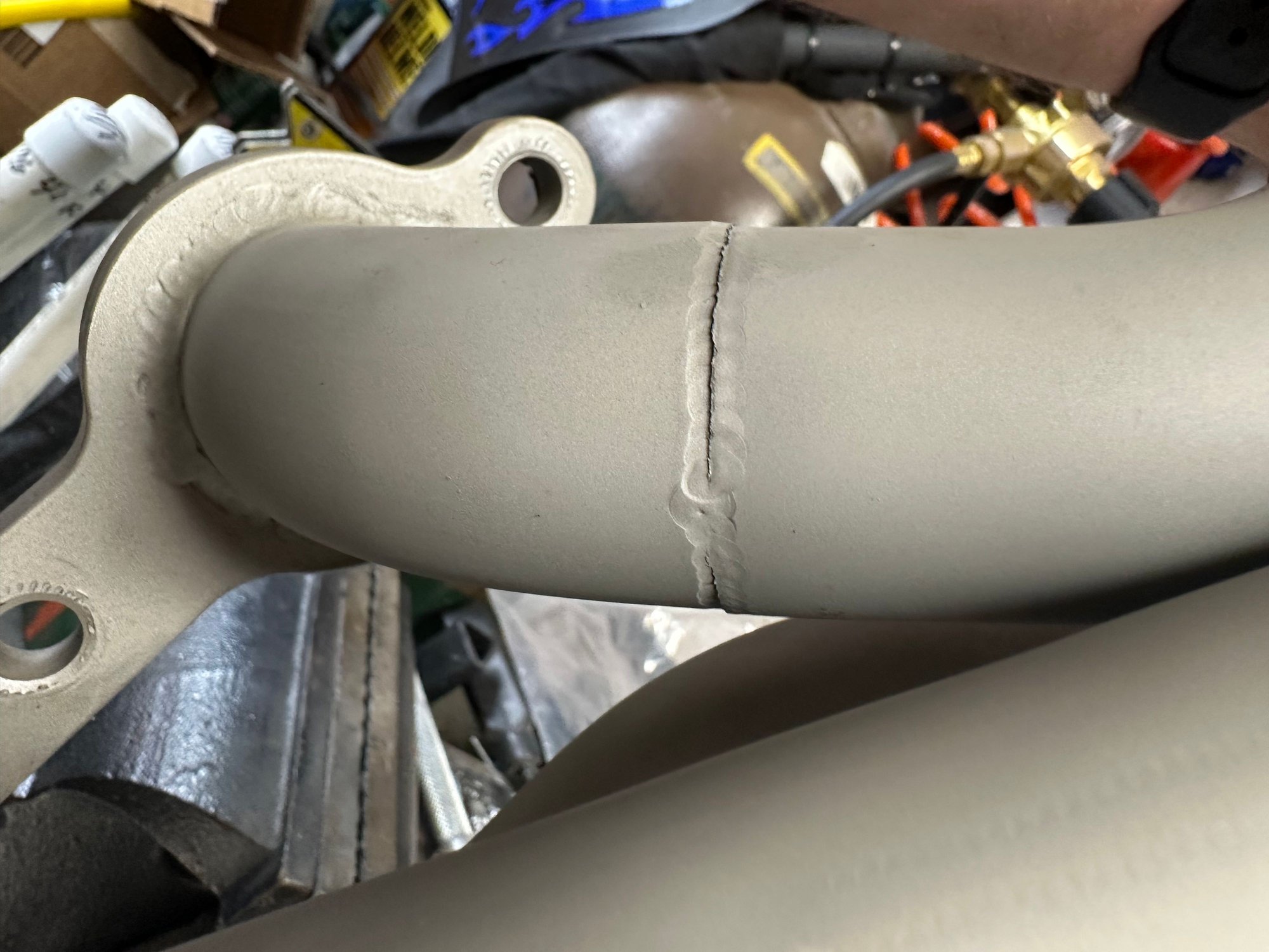

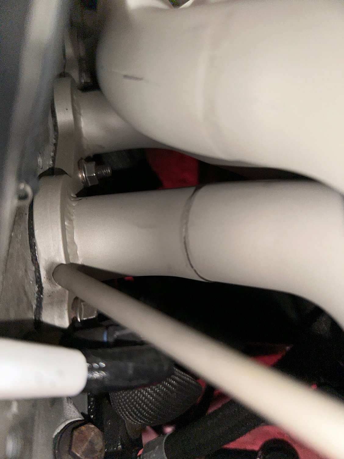

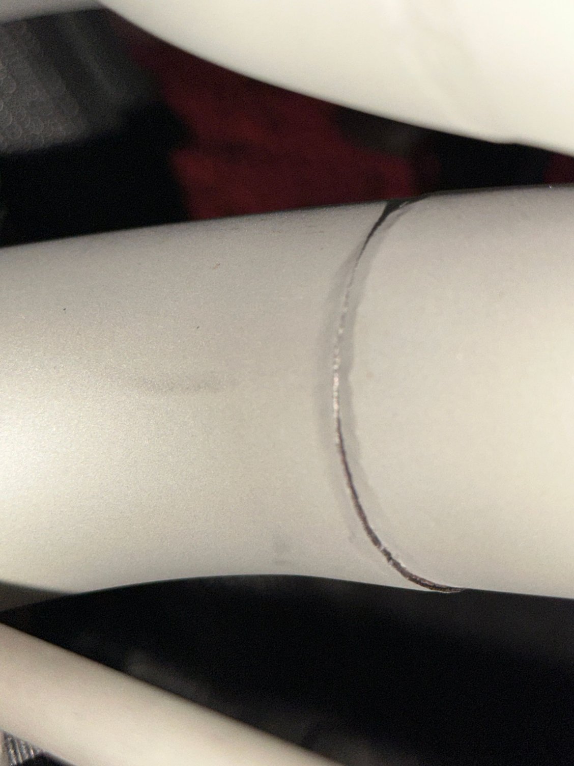

Just to update on mine. Car sat for like a year almost but got it out a few times recently. Got a tick under the hood that i noticed and started looking around. Looks like the driver side header primary front cylinder cracked all the way around. Annoying that I will have to pull the header to fix but this also happened on the opposite side pretty early on (same front cylinder but on the pass side). My guess is the short tubing and the lack of any filler rod on this “show” tig pulse welds.
keep an eye on your welds guys.

That sucks. When I took a welding class in 1994 the instructor told me strong welds are not pretty and pretty welds are not strong. A lot of guys making 'show quality' stuff are concentrating too hard on making the weld look pretty then adequate penetration and filler.
That said, I'm a huge fan of cast iron/steel for turbo manifolds. They won't flow as well but the durability is better.

Ended up pulling it today and welding it. Not
fun getting the weld all the way around but its

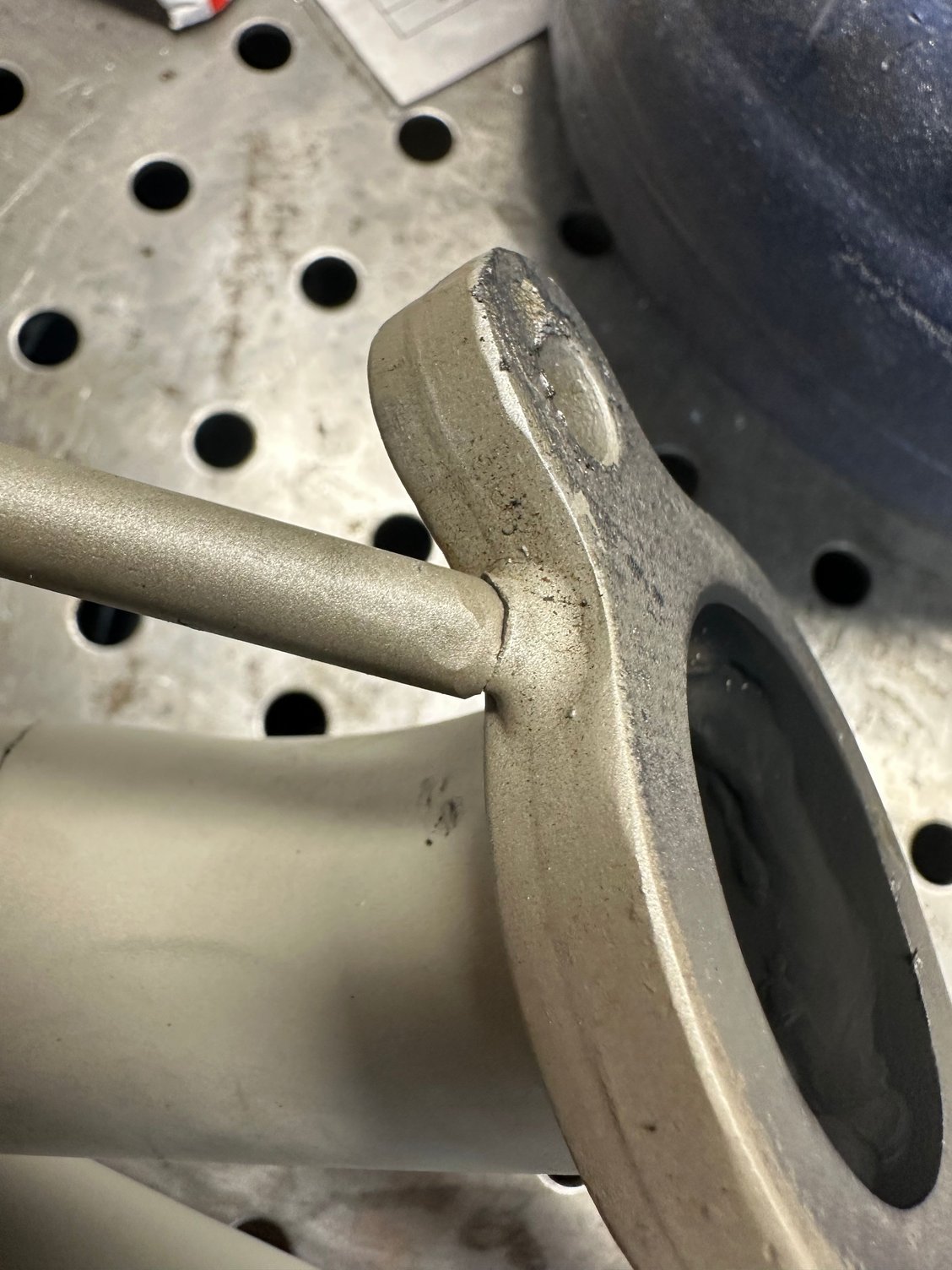

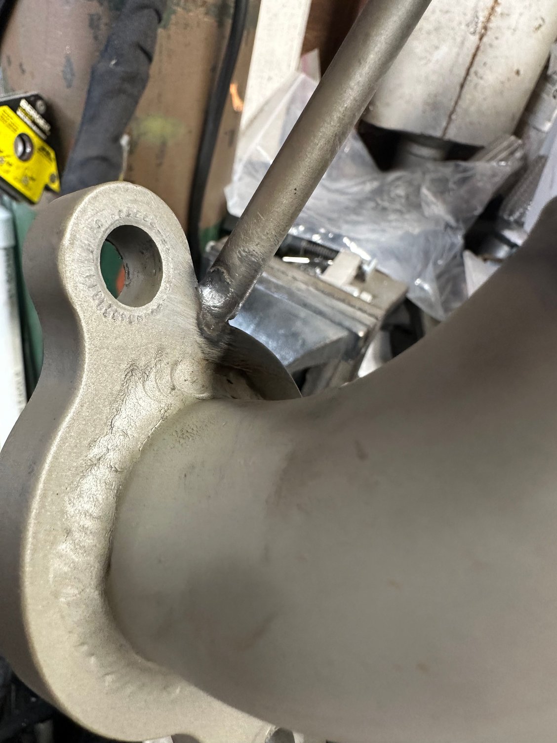

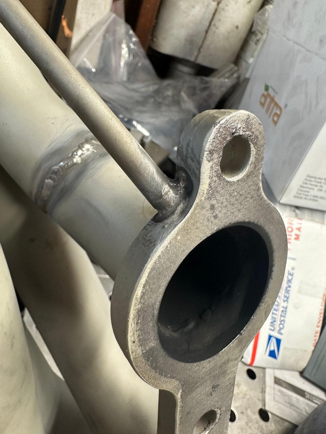

done I also found that the support on the front of the driver header cracked at the head flange. Probably either the result of the primary cracking or it pushed the primary into cracking. What’s weird is that it was the same primary as the passenger side front short sweep with a 90. Maybe it’s bc the are the closest and shortest runs to the collector causing them to crack with heat cycles? Idk…. The pass side hasn’t cracked since I fixed it years ago so I hope this one holds too. I welded the support rod back in and added some more weld to reinforce it. Then hit it with some black creakote I had to help with rust. A new PS pump was suppose to come today but USPS never dropped
