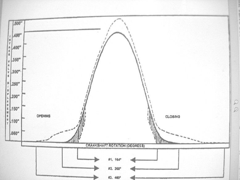

Found a little of old documents: Just so no one thinks I did not see these earlier:

Re: Floating intake power valves
