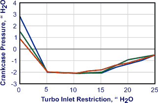

Notes (some repeats to make sure you don't miss anything):
-frequently pressure test the plumbing, a leak will rise EGT/IAT and destroy OEM pistons
-High quality air filter drives PCV at wide open throttle and protects the pistons and crankcase. Without this the engine will smoke, leak, and burn oil.
Mileage and long term reliability is directly correlated to air filtration and PCV actions, assuming everything else is done right these are the limiting reagents.

@Kingtal0n,
Thank you for the super detailed information. That really sucks to hear about the 80e and gear 4. I'm a set it and forget it kinda guy and there is no way I won't be in 4 at some point and nail the gas for a kickdown. I'm on a Holley Dominator so I have a lot of options for programming the transmission, hopefully I can build in a protection for that to prevent downshift or something. Dana helped me with my 700R4 and all these years later that transmission was still kicking. It did start slipping in third at 550 rwhp but heck it's been 10-11 years since I built it! The fluid I drained last week looks perfect too. I thought I'd probably talk to him on the 80e at some point. The one I have now is stockish and I'll be replacing it with a built one later, if I find myself using and liking the car enough.
Can you clarify what you were saying about the PCV and air filter(s). Were you saying run a good air filter on the PCV, or talking about tieing it into the intake track and engine air filter?

Like these
At WOT you can measure crankcase pressure like this
It will give you data like this if you measure at the inlet also
The Holley ECU has a 0-5v analog input for this measurement, you may use 2-bar map sensor on the crankcase AND/OR inlet tube to dial in the WOT PCV flow.
The goal is to produce a vacuum inside the crankcase during ALL conditions, not just Idle/cruise but also WOT.
This is essential for maintaining cleanliness inside the crankcase, it will protect engine oil and prevent contamination which leads to atherosclerosis of the oil system, deposits and carbon buildup in the oil orifices which are very small in modern engines.
It is perhaps the most overlooked and underappreciated aspect of reliability and engine health of all, I suppose because the damage is invisible to us from the outside.
Like start smoking, 1 day, 1 week, 1 year, you can't really tell what the smoke is doing to the insides of a human body (or crankcase in this case). But there is damage being done all over. The circulatory system carries blood/oil to all orifices where tissue/parts depend on the oil/blood to be clean and this will have impact on anything the oil touches.
Use a Supra 96-98 Twin Turbo PCV valve inline with OEM chevrolet pcv valve on the intake suction side.
I cover all this in details in those links I posted, and more. This is just a summary.
All we are really doing is re-establishing the OEM pcv system performance. Everything I show is essentially an OEM PCV targets for crankcase evacuation, its how they make engines that go 200k 300k miles and more.... air filtering and PCV together do that.
Great idea thank you. Also measuring and logging crankcase pressure would identify new problems quickly. I'm definitely going to add this in to my setup. Once again thanks for the super detailed information.
YES! The crankcase pressure monitor is an early warning system, and overall indicator of engine health and conditions related to piston ring function.
Intake tube restriction = Pressure drop to drive WOT pcv
You can monitor crankcase pressure from either valve cover or even the oil cap as shown earlier.

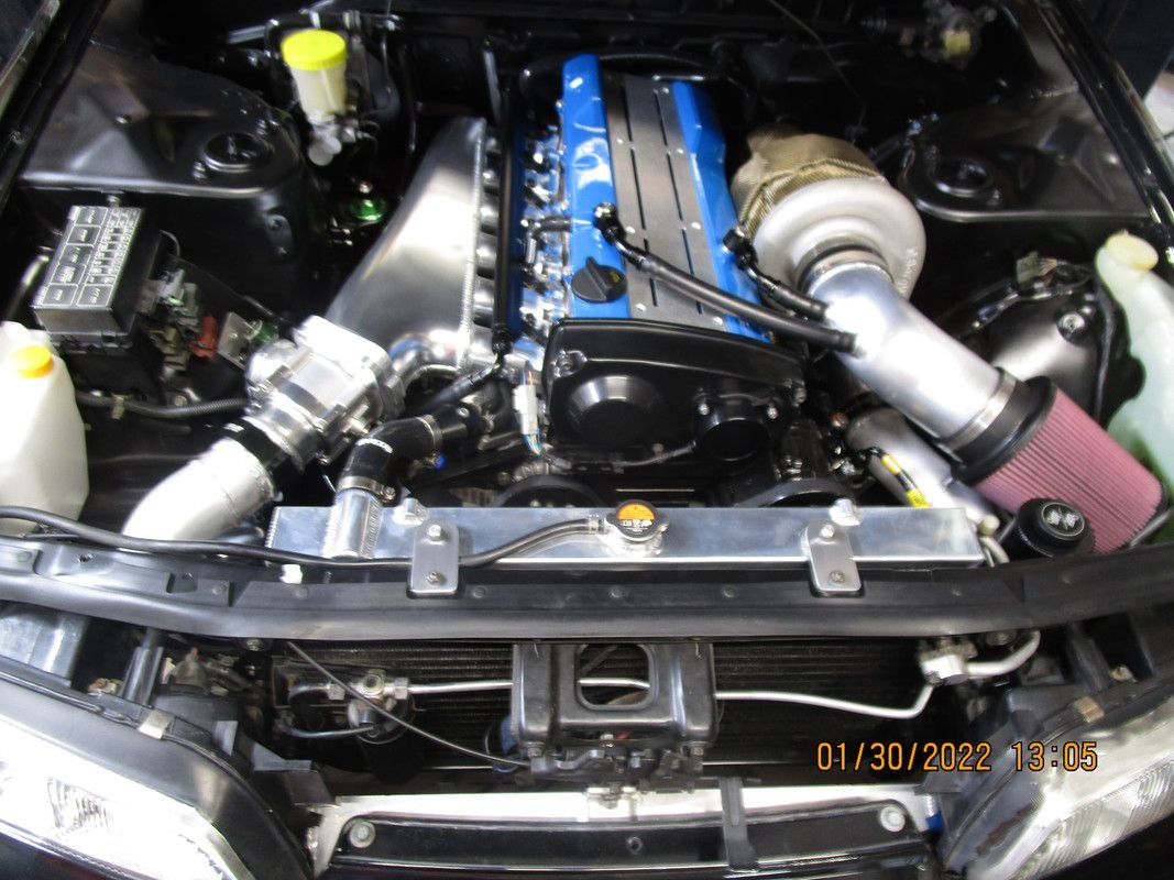

Remember to heavily insulate the exhaust and turbine, use quality DEI wrap and turbo blankets, put shields around it, Insulating covers, blankets, whatever it takes to keep the heat out of the engine bay. Use an IR thermometer to measure all surface temps and take action to reduce as needed. The Intake plastic should run 145 to 160*F by my measurements. The valve cover around the temp of hot oil (200*F~). Don't let valve covers go much higher than oil temps, as they will if you do not insulate and shield well enough and this will cook the valvetrain hardware reducing reliability. I'm still on my first set of LS plug wires, they have 45k miles and around 4 years of daily driving on them, the OEM truck exhaust manifolds and heavily wrapped probably keeping them alive. Pretty happy coming from SBC land as you are prob aware. The LS engine never even misfired once, not a single time, ever in all the time I've been running around with it. Pretty amazing. And all I did was: nothing. I kept all the OEM high mileage coils (use D585 up to 1000rwhp)
, OEM harness and OEM style plug wires and did as little as possible. Treat it like a high mileage work truck. Use TR7 Iridium plugs gapped ~0.025" (no less than .022" and no more than 0.028") 600rwhp gasoline or 1000rw ethanol.
I tune the engine on cheap copper plugs then just before cleaning up on dyno install Iridium NGK and then never remove the plugs or look at them again. This keeps them in great shape, never take them out if you want high mileage from them.
If you want the secret to longevity its basically doing less and less anywhere you can.
Also, Make sure you separate the Downpipe heat from the Exhaust manifold heat. If the exhaust manifold heat can reach the downpipe, it will create excessive backpressure in the downpipe and hinder performance, as fluid temp needs to drop as it leaves the turbine towards exit. It will probably take two lightweight aluminum shields separating the two, along with the wrap around everything. Most people just use a fender exit so this isn't an issue; however I only build daily drivers so it is necessary to run a full length exhaust with OEM style mufflers and this is what I've learned from years of doing that.
its the little things that make the overall biggest difference. You should be able to drive normally in any conditions, wot whenever you want, and not have to worry about engine bay heating or residual heating of parts, with enough insulating and shieldings. You can get most of it for nearly free at junkyards like U-pull-it, Walk around find a car with the engine removed and there are often a bunch of high quality OEM shields to remove with 10mm hardware. Pretty fast and new looking since nobody ever touches the stuff. Fabricate a nice thin shield for the starter if the downpipe runs by, although even with crappy battery voltage the OEM starter never gave me trouble despite its 250*F temps after hours of highway and then traffic. Thin lightweight aluminum will reflect radiated heat but won't do much for the convective heat carried by airflow, high energy air molecules transferring heat to parts, for that you will need insulation. Together insulation and shields are a kind of key to the whole turbo daily driver thing.
Thanks and good luck, ask anything I will always try to help, sorry this is an enormous topic worthy of a pretty large book so I keep trying to summarize as much as I can.
