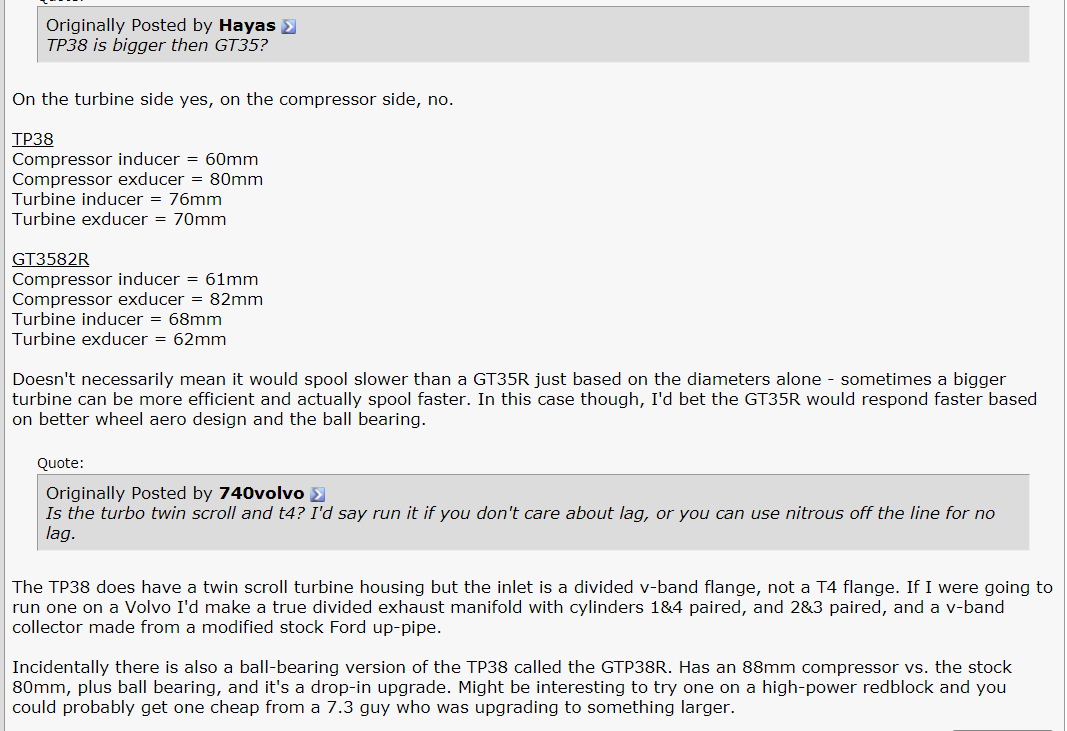

Orr, I've spent hours looking on the web today, and there are apparently no GTP-38 compressor maps to be had. But from what I can determine, the wheel sizes are the same as the older TP-38, only the A/R on both sides has been tweaked some. I think I read somewhere that the hot side A/R is .85, and the blower says 1.0 A/R on the housing.
This is a little confusing to me (same size wheels), because the turbo itself looks physically larger, plus the pressure piping on the engine is literally twice the diameter,

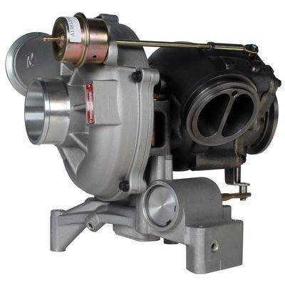

Here is a photo of the GTP for reference. If you've never seen one, it is twice the size of the GN turbo. and that valve at the bottom can shut off the exhaust exit completely.
GTP-38

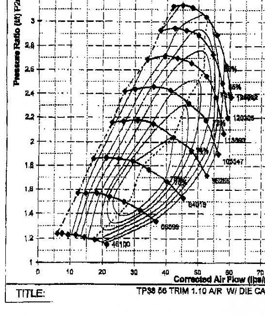

From what I have read here and there, it would seem that the TP-38 may be roughly comparable to the GT-35. Here is a map, and a screenshot with some helpful information:
TP-38 Map

On that map i am getting different Pressure numbers than crossfire did. No way you’ll see pressure ratios much above 2 imo to get that power number. But he said stock lt1 so that could be the difference
800 flywheel on a cammed lt1 should happen by 15 psi or pr of 2-2.1. Thats 80 lbs a min. Give or take, on e85 it helps make more power than pump gas.
a single tp38 would be riding all over the choke side of the curve. Even at low boost numbers. Simply isnt enough compressor to feed the demand.
