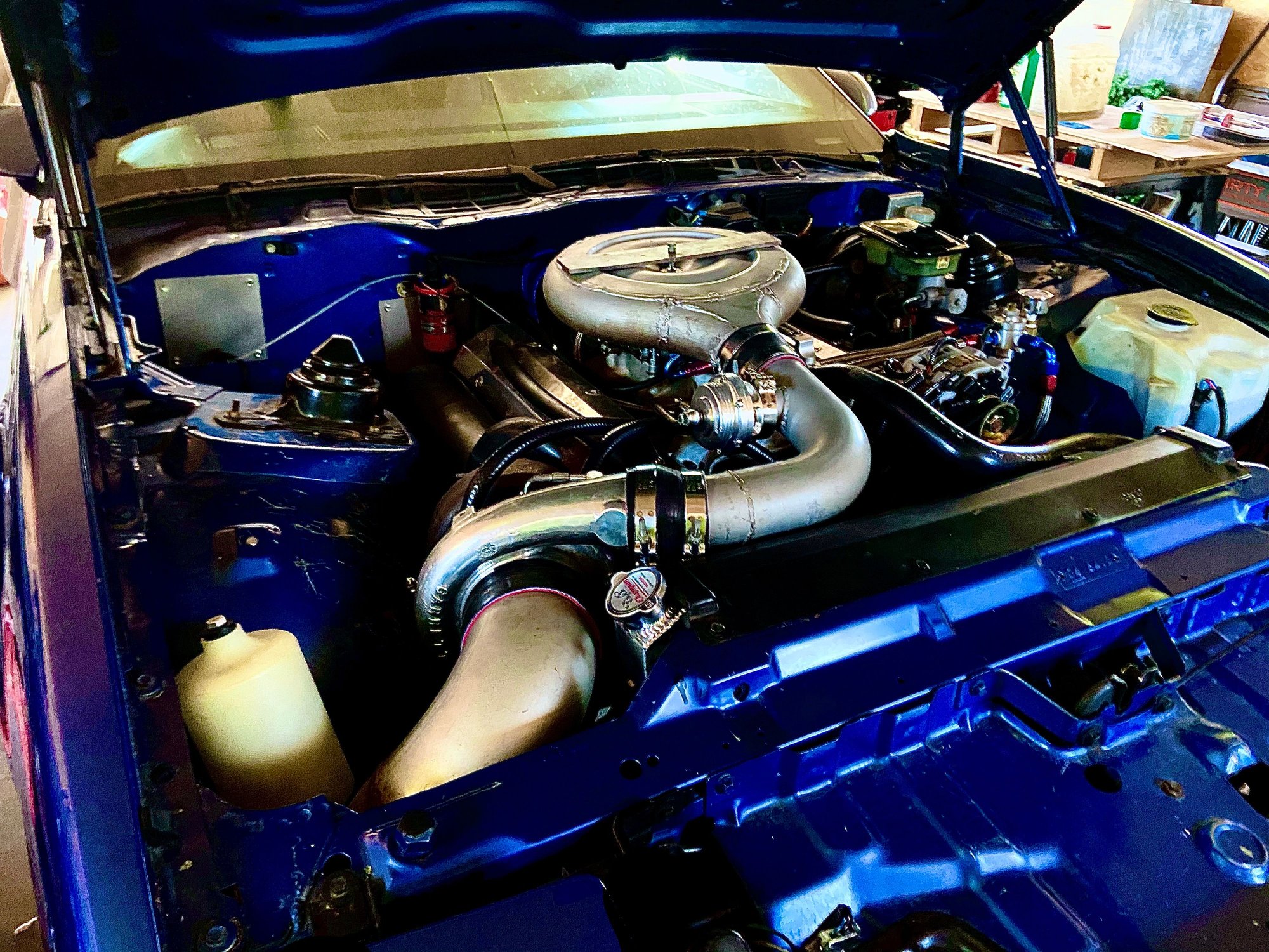

Took some pics of the pile the other day. Been sitting for four years

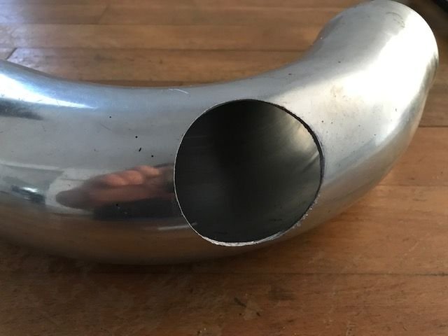

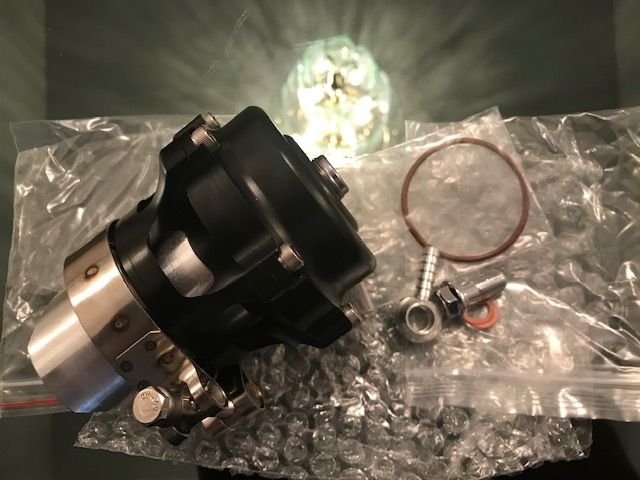

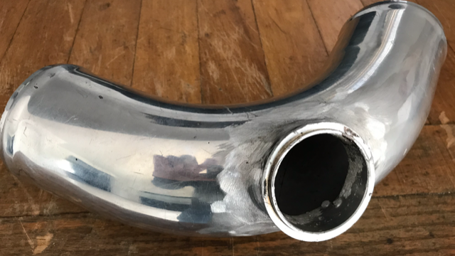

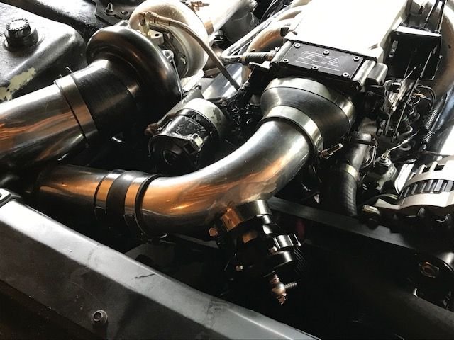

I like the location of the BOV in the first pic. I ordered a new one two days ago, coming in from Florida. Old setup had it down by the FMIC. Thinking of installing it right at the bend of the ninety degree tube off the throttle body, partially facing the battery and radiator. Would definitely like to see some walk around's from you guys whenever possible. Finally had mine out on the street last night tuning. Slowly getting there again...

Nice work Rob! I'll try and get a walk around vid tomorrow or Sunday. I love how the turbine housing and my dynomax muffler really quiets it down. If it didn't reek of Ethanol people would never know. I'll keep you posted on the vid.

Yeah, I've been taking it easy myself for that very reason. No more than 15* of timing above 10-psi, but I won't be seeing 18-psi like that anytime soon. We'll start up a new walk around thread soon, no worries, definitely take your time with the fix. On a side note, my new BOV just got here literally a few minutes ago, can't believe it took this long for the mail to get here. Any other day it would have been here at ten in the morning. But I digress. Will keep you guys updated with my progress as well...

Looks like a nice piece. I'm at 21-22 degrees timing at anything above 10 psi. It's weird though... I was doing some test hits on the country roads by my house and I pulled third to about 110 mph and pushed in the clutch to coast and brake. It just shut off. I let it cool down and it cranked over fine for the many times I tried restarting it. Then all of a sudden it turned over and thud... Radiator is full. Oil looks / smells good. I wonder if it's the plugs.... They are NGK 7's (too hot for what I'm doing but that's all they had in stock) I ordered some 10 heat range, a much colder plug that I need. Any ideas? I run the MSD Digital 6AL-2. So it pulls timing where I want it. I got it towed home and didn't really mess with it... Just bummed out. Let me know your thoughts.

Well, I got it somewhat back together. I'm just waiting on my cold plugs and my BLP Viton needle and seats. .150. This shouldn't happen again. Should be able to try and fire it up this weekend or early next week. I'm balancing a few projects right now but the car is probably most important. I'll keep you guys updated.
Quick update for you guys. Self explanatory though lol. Happy with the way it came out...
Needs to polish it though.
- Rob

Looks good Rob. Very similar to mine. What turbo are you running again? I changed oil, installed 4 plugs... the other 4 should be here tonight yet. I also got my BLP bottom feed N/S .150. I’ll get all this wrapped up by Monday or so. Too bad it’s over 100 degrees here and humid.
