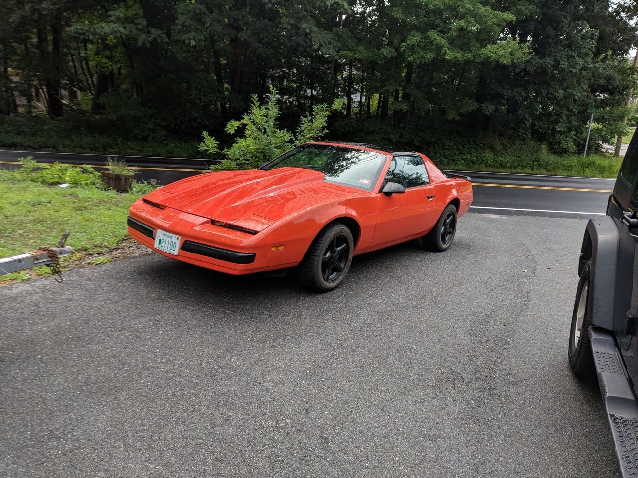

So I guess we're back to what to do with my thirdgen, and I think at this point it makes the most sense to pull the 412 and stick it in the C3 naturally aspirated, and do rear end gears. And sell the thirdgen as a roller. Maybe someone would love to put there own engine in it. It's a fully restored car, with tubular suspension, k-member, new interior, etc.
-- Joe
