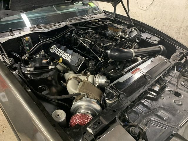

Repainted the engine bay. The vintage air stuff (heat only) came in. I'll probably put the engine in sometime next week. I have the a-arms off the car, swapping springs, a-arms, and camber/caster plates.
I was hoping to get this thing moving by Christmas, but, that's probably unlikely at this point. Hopefully sometime shortly after the new year
That bay looks sweet. Hey quick question, ever thought about a quick hammer, dolly, and mud on the fender turbo space to smoothe it out? Or will that turbo/piping block enough of it off so it won't be in view?
I don't think it's going to be visible once the turbo and piping are in place, but I like the idea of heat shields such as those shown in the image posted by @battmann above. I think it's probably a good idea to keep the paint from burning. The eastwood engine bay paint is rated for like 220 degrees. In a n/a engine I wouldn't be as concerned, but I've seen turbo piping bright red!
I might work on the fuel lines tonight, clutch master, brake booster, etc.
I saw battmanns heat shield. Very nice. My setup glowed here and there. It never melted the paint area, but it was the original bay paint with 900 years. Also I was short bursts. What are you running for lines? Stock? EVAP as a 2nd line?
Pretty much the same setup as whe. I had the supercharged 412.
Ls1 fuel tank, 470lph pump I to some 3/8 lines. 8 awg wiring for the pump. I'm removed the factory fuel lines a decade ago. Going to mount the regulator on the driver strut tower.
I cut up some factory LS2 fuel rails so I'll have parallel feed and return.
When I did a flow test of this setuo a few years ago I got over 450lph on the return side with the rail pressure set at 60psi so it should be plenty for the smaller 70/70 turbo.
I'm thinking the 5.3 I built is probably about 400hp naturally aspirated, so in theory 12-14lbs of boost should put it 700 or so horsepower.
In reality, there are all sorts of other issues with the car preventing me from pushing more power. Rear end, transmission, no roll bar, SFI belts, etc.
My goal is to basically be a no prep radial tire 125mph 1/4 mile far.
Think I'm crazy?
-- Joe

Re: Offshore cast turbo manifold LS build
I added the heat shield because my new paint was cracking on the inner fender. The stuff I used was DEI 50552. I used black because I thought it went better with my build theme but DEI makes this in silver too. It’s adhesive backed so you only get one shot to place it. I had to add DEI 10039 heat tape to the edge of the heat shield because the heat was making the top metal layer pull away from the fiber layer below.
I originally wanted to put heat wrap on my headers but couldn’t find the stuff I saw on some high end car builds at the Columbus Goodguys show. Below is a picture. Anyone know what this product is??
oh crap forgot to add my downpipe and headers were coated and wrapped
Cant find a pic of the wrap, that was the dei "ceramic coatiing" in the can, Held up pretty well, Also I sprayed the wrap with the dei stuff to. IDK how tough the Oem paint is but I never saw any blistering. But i didn't care, paint was shot.

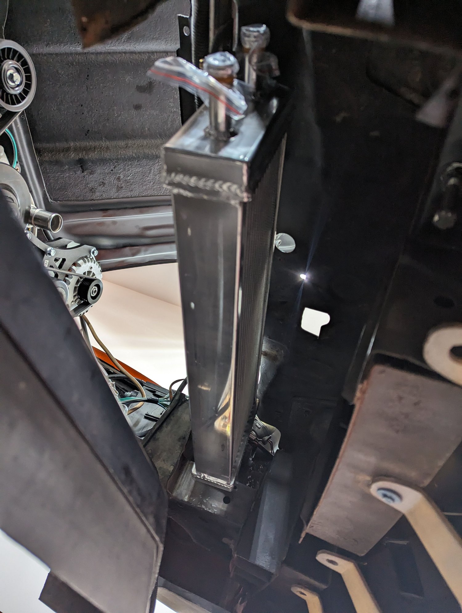

For your IAT just grab a little weld bung and put it on your IC piping. This is what I ended up doing with mine. The other two bungs up by the TB are for a water meth system
Good idea! I can put it on the pipe that my BOV is mounted on. I think it's 3/8 NPT, they should sell aluminum bungs for that.
Thanks!

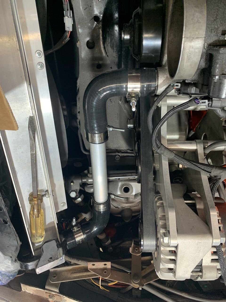

Post a pic of the upper Hose and the distance from the
water pump outlet to the upper rad hose connection. Also let me know if you cut any sections out. I would love to find a solid single upper hose to clean up the engine bay.
for the steam port I just drilled and tapped the back upper (behind the outlet) for 1/8 not and run a piece of silicone hose to the front driver steam port on the head. I always do this or get the spacers with the pre drilled port. Since the Camaro ls3 pump doesn’t need spacers I did it like that as it’s cleaner.
Idk if u can see it in the picture

I can see it. I'm not sure that that would work with the LS3 crossover I bought, I'd have to do a 180 degree loop with the hose. I guess it's something to think of, the water pump could come back off in two seconds.
This is a factory Corvette L98 upper radiator hose. I may or may not run it. It works, although It would likely be better to have something with just two 90 degree bends.

Yea, I used a longer piece of silicone hose prob 10" or so and did a 180 loop back to the front driver head steam port. I think I run the same LS3 steam setup which is a front crossover and two plugs for the back. I then put a small ziptie to hold the hose to the steam crossover and keep it from moving around or getting in the way.

Heat exchanger mocked up. Fits good! Running dual 10" fans.

Getting a little more closer. Intake routing almost works. I have not made the mounts for the intercooler yet until the hoses are 100% decided. I'm on the fence right now about the BOV. It fits where it is, but it's after the intercooler. I have some room if I welded the flange ON the intercooler and had the valve basically vent into the fender. You can see on the passenger side where I'm talking about.
