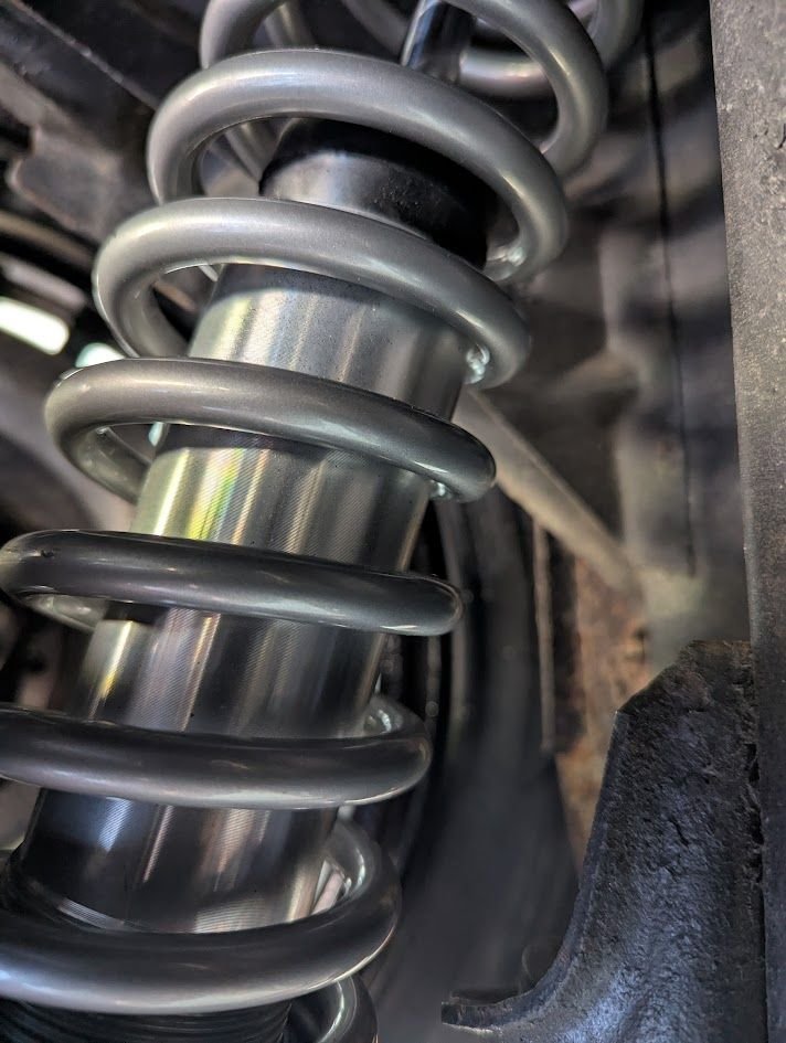

I don't think compressing a spring affects the rate. what you said about affecting height sure but the same could be said for the correct height spring. What it does change is is the height but the rate is linear unless you have a progressive spring.so a 100lb/in spring will still be 100lb/in if you compress it 3".
I agree on the angle of the shocks, I don't think they are optimal with the rear coilover. IRS has its own problems but have many benefits as well. IRS wins in adjustability and cornering loads/geometry.
There is def alot to understand and alot of it is over my head lol. Build the car for how to drive it, a 4 link prob not for the street, the Tq arm is a good all around and going to an IRS prob not worth it on this type of car and it's intended use.

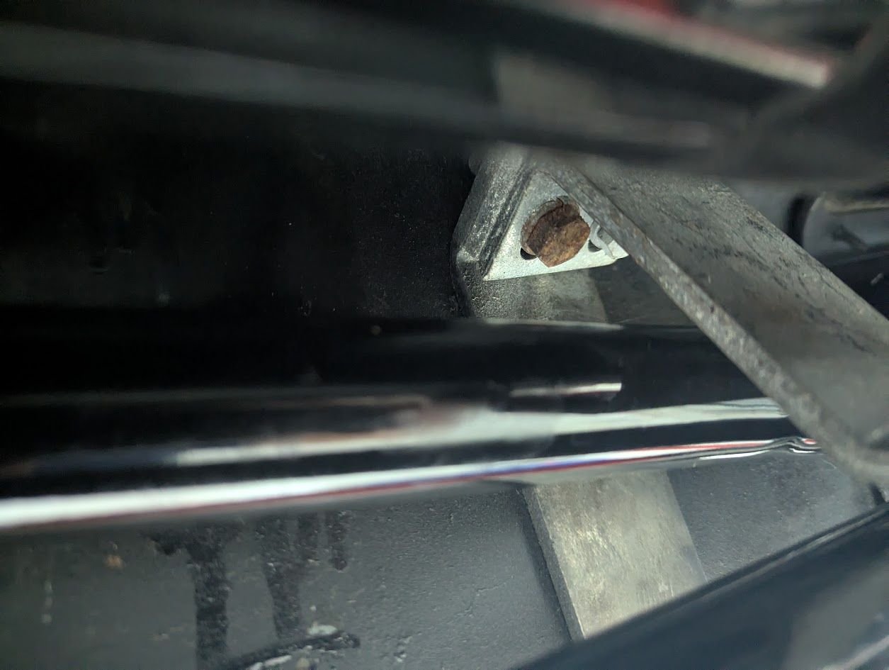

I used the wrong word there. Not the rate, but the preload. It's sorta like a valve spring - the more you compress it the more pressure is required. So let's say for example I have a 14" spring installed at 14", it might be 150lbs to move it the first inch, then 300lbs to move it the second inch, and so on. By adjusting the spring preload you can influence how much weight is required to compress the shock from the installed height (19") to your desired ride height (in my case, 15.5").
Anyhow. I modified the UMI torque arm mount simply by adding some 3/8 flat bar to it to move the torque arm 1" over. This should work for now until I decide long term what I'd like to do.
I was looking at everything and I think the correct way, as I mentioned previously, to do the coil overs would be to cut the spring perches off the housing and mount the coil over on the back side of the axle tube. The issue is the panhard mount. This goes back to my thinking that a triangulated four link would work good because you don't need a panhard. A setup like this:
But I have more reading to do. Maybe in the fall.

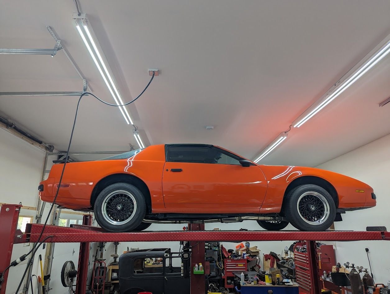

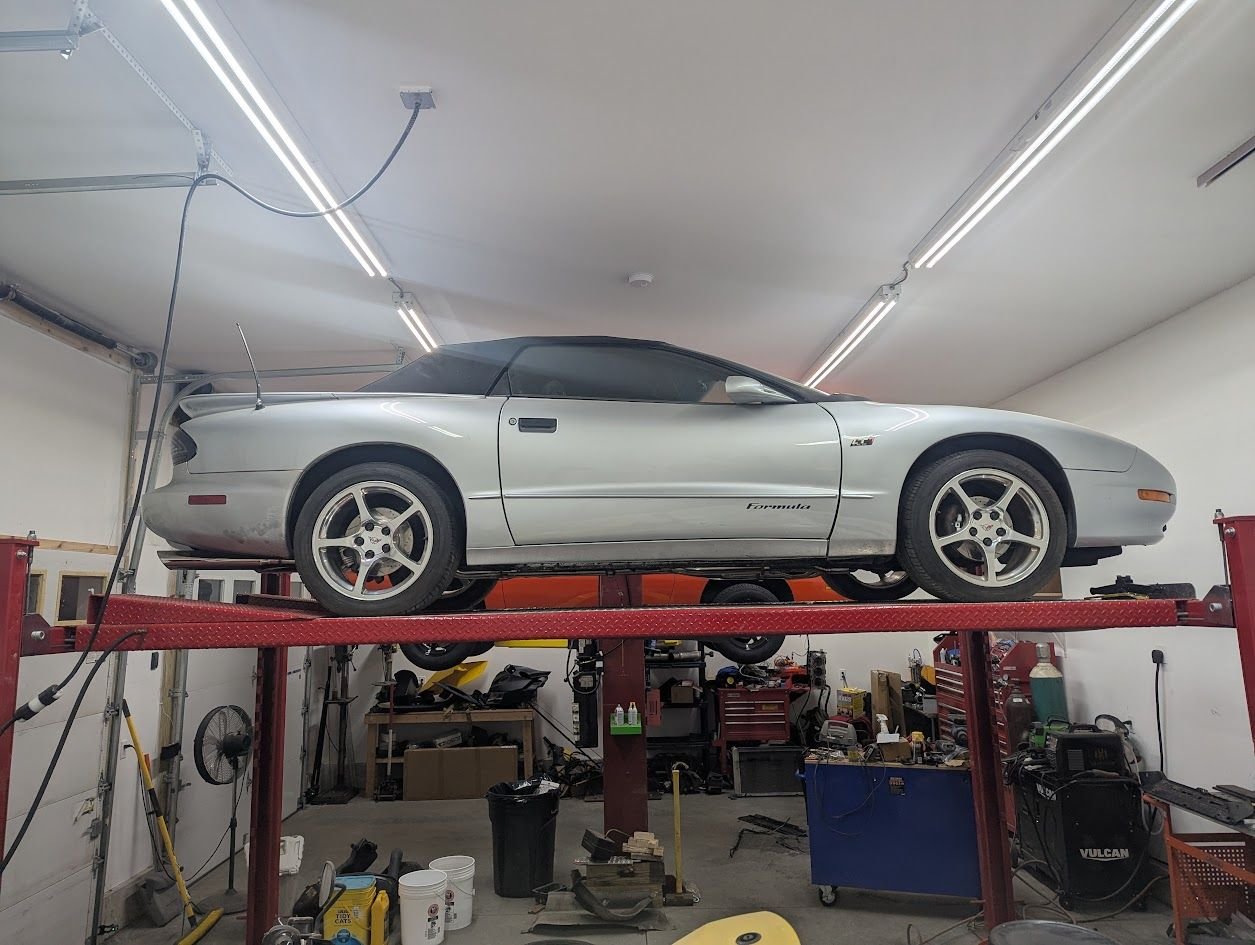

What do you guys think about the 17x9 GTA wheels for a street strip car? They suggest a 275/40/17 tire. I'm running 275/40/18 on my fourth gen, and I feel like it's not enough sidewall for drag racing, especially with a manual. But I could be wrong.
I was considering putting the 15" drag star wheels on my model A and going a different direction on the third gen, but I'm not sure if I should just do a 15" pontiac wheel with a tall tire or go with the 17x9s.

Years ago I had 17x9s w 275/40s. They were sticky yokos. That was w an efi zz4. The were OK but not anywhere near a drag setup. It cornered great and hooked up OK, there were times I wondered if my clutch was slipping in lower gears but I think it was the tires spinning. Now I have 18x10 rears w 305/35s NT 01s. They are really sticky road race tires. They still wouldn't flex like a drag tire. They're great and hook up 550hp really well, but I don't think they'll ever hook like a drag tire. But they are a great for corners and controlled silliness. I see people w similar power to what I have lifting their front tires off the ground. They have drag tires. I couldn't see my car lifting the front end at all w the tires it has. I mean, it hooks great but not like that.

I currently run a 17x9.5 with a Mickey Thompson Street SS 275/40-17 with them aired down to 20 psi and they hook pretty good. I do find when I'm really giving it the sauce that it tries to spin off the 1-2 shift but nothing too bad

I love the GTA wheels on our cars and the 17x9 is an upgrade to the stock 16x8 but I wouldn’t do anything 17”. I run 18x9.5 and I have 285/45r18 Micky ET street drag radials. Made a big difference over the 275/45r18 sumimoto’s I had. They are a ticker sidewall 28” tall tire. I would run that or a 305/40 or something similar for more contact patch. With the similar combo you have I can still break them loose but not nearly as scary having run on the road. I have put about 5k miles on them and they are still good on tread.
18” has become the most available tire size due to the OEMs. Probably more options than 15 and 17” at this point.

I have 275/40/18 on my fourth gen. Looks ok on the 4th gen but I feel like such a low profile tire with a large diameter wheel on a thirdgen looks out of place.

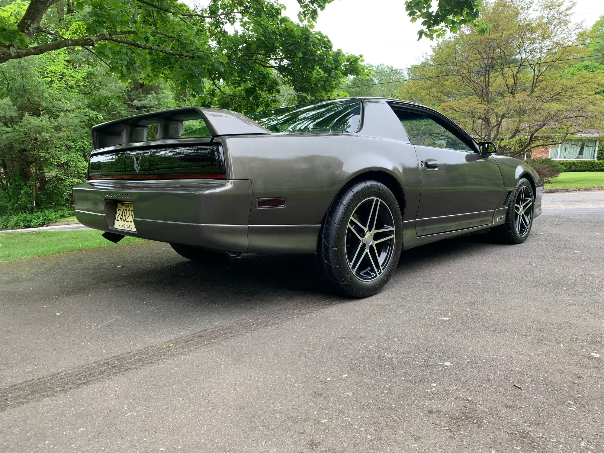

Got a recent photo of your car showing the wheels?
My rear is a 285/45/18 tire so it’s a thicker sidewall 28.1” total height. You can see the 40 series in the front and 45 series in the back. The 45 series fills out the wheel wells nicely compared to the 40s. I even had to raise the rear due to the tire height and rolled the rear flares as it cut into the sidewall at some point. I run full aftermarket suspension and 175lb weight jacks and Viking double adjustable shocks. With the 3.55s and 28” drag radials I can still spin the tires on the street but it’s much better than the 275/40/18 summer tires that I have on the front (I ran them on all 4 at one point).
Looks good. I almost bought a trans-am parts car a few months ago to use the ground fx and bumpers on my formula. I really think the trans-am's look better.

I think I figured it out last night, but I didn't think it was possible. But I found the top of the torque arm mashed with the powder coat banged off. It looks like what is happening is, on suspension squat the torque arm is hitting the driveshaft loop. Which is surprising because it's like right behind the pivot point. I didn't think it would be moving 2+ inches in that spot..
The only place the exhaust is close is in the rear on the sides of the spring perch support but it's always been like that. I could put some rubber to insulate it but that's not the bang I don't think.

I was thinking the same thing but there is an impact mark on the arm.
I'm going to do exactly that, jack the body up and see what happens when the rear end squats.

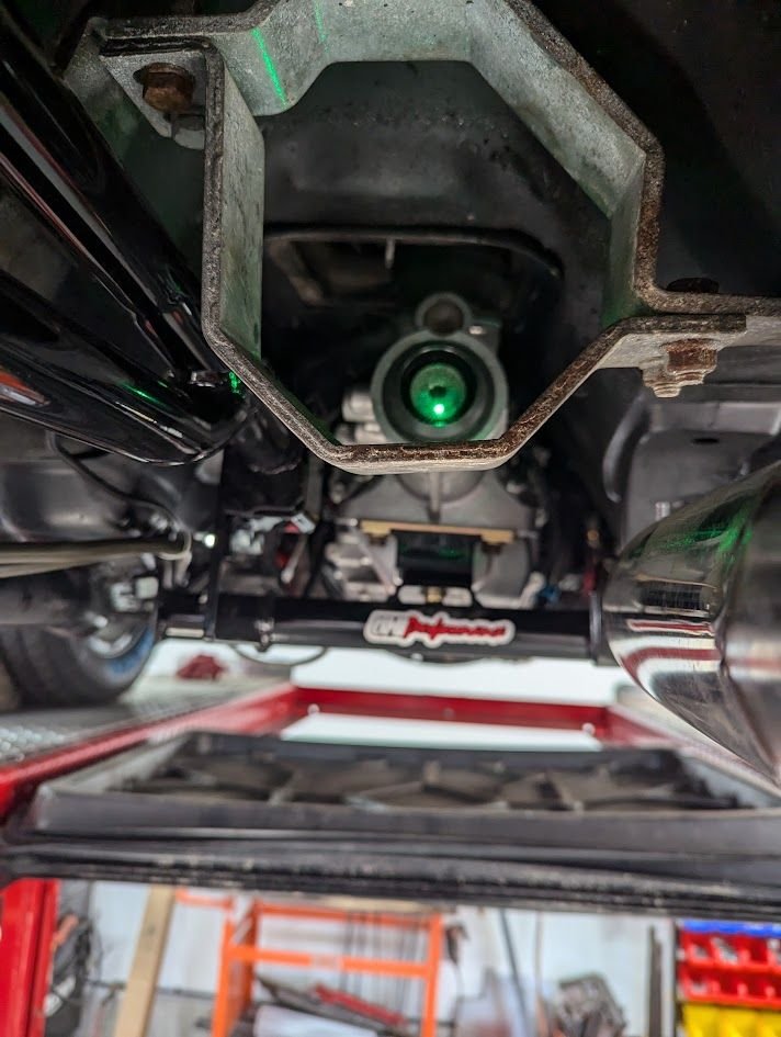

This the front mount. The round slip fit connected to the crossmember.

I found a really good ding in the top of the TA about 3" back from where the driveshaft loop is, so I'm curious if when the rear end squats the TA is moving forward and up in the front?
I need to compress the suspension and see what it does.

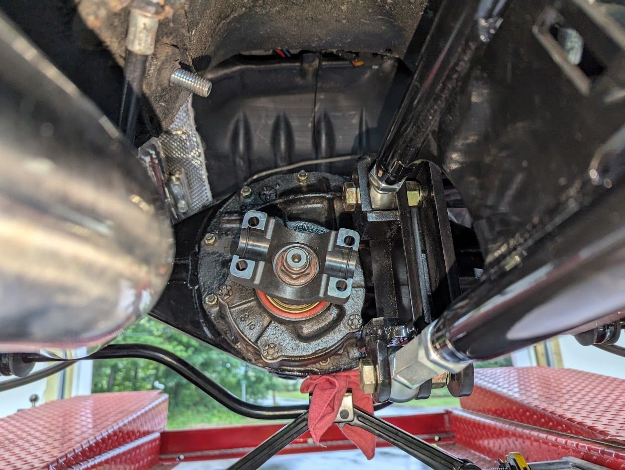

The rear end will move side to side about 3/4” if I had to guess maybe more during the arc swing of the panhard bar. I don’t think you would be seeing that much movement in normal range of motion tho.
how much space do you have if the arm moves forward before it contacts?
if I logically think of what happens on a shift or let out of the clutch I don’t envision the arm sliding forward that much or back. Loading bs unloading the rear.

Well, it definitely is not hitting side to side. I can't see any signs of that. The only abrasion I found on the torque arm is about 2" rear of the driveshaft loop, and there is about 2" of clearance on the front. I need to take the coil overs out and see how much the suspension compresses to see what is going on. I may do that today.
I know for certain the back of the torque arm/adapter is not hitting the tunnel. There are no signs of impact, and all of the noise is up front.
I did media blast and paint these stock 16" GTA wheels though with new rubbers. I think they look better than the drag wheels.
I know you like 18's and I do have 18's on my fourth gen, but I just think they look weird on a third gen:
get those cool overs out and get to testing lol.
I love the GTA wheels, they look great on your car. Just gotta close up that ride height down.
I had original GTA wheels but always hated the 16”x8 size. Hawks has the 17x9 which is better and I would love a 18x9.5 or 10” width option. I’m not even sure if my 13” BAER black label brakes will clear a 16” rim. I would totally
put a GTA wheel back on but with the turbo I can’t run anything smaller than a 275 tire and I would prob do better with a 285-315 rear tire.
Thank you! I think they look better than the drag wheels. I put the drag wheels on my Model A.
One thing I noticed, the spring likes to lean to one side. I don't know why. Correct spring ID for the shock. Strange shocks, not chinese junk.
I wonder if the coils are making noise?
I tested the car on the road again, I can get it to make noise when the rear end squats or goes up.

I wonder if the spring is catching the top of the shock and popping when compressing? I do Not love how that spring looks. I wonder if it’s also because of how long and narrow the springs are.
did you pull the springs and do a full range of motion test?

No, I had to fly to DC for work and just got back last night before midnight. I'm going to try and tinker with it today. But I was thinking the same thing.
These are 14" 2.5" ID 150lb springs. I'd imagine the same everyone uses. I don't know why they deflect like that. Here is a better photo. This is ride height:
