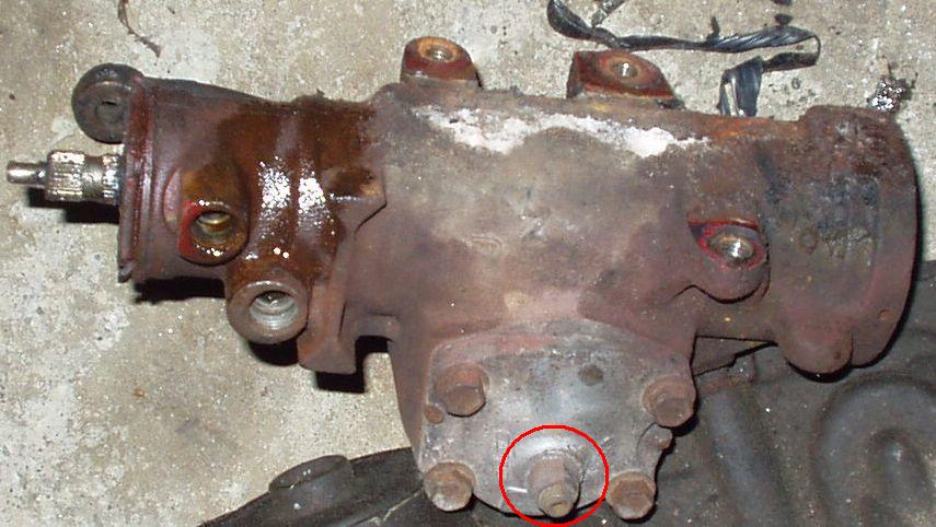

if you crawl under your front end and have a look around you can pretty much figure out what everything does. the balljoints allow the knuckle that holds the wheel on to stay vertical as the control arm that it's attached to moves in a circular path when you corner or go over a bump. our cars don't have radius arms. other then that it's all self explainitory when you look at it. to check your ball joint you want to get the tire off the ground and then push at the top and bottom of the tire to see if there's play, to check your tie rods push on the left and right side of the tire to see if there's play, there shouldn't be any.
there is an adjustment screw on the steering gear to take the play out of your steering wheel. loosen the outside nut, turn the inside screw with an allen wrench and then tighten the big nut around it, do 1/4 turn increments on the inside screw and don't over do it cuz you'll bind stuff up. after each 1/4 turn, turn the car on and see how the steering feels, you shouldn't feel any binding.
