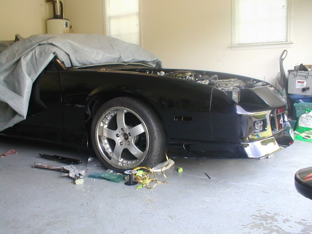

I have 18x9 fronts and 19x11 rears. Dropped spindles in the front with coilovers on koni shocks, and rear koni coilovers. Don't really have any good pics though...car is still in the "build" phase. Here is the best pic I have of the front.

beautifull. where did you get the drop spindles. they are hard to find!!!
