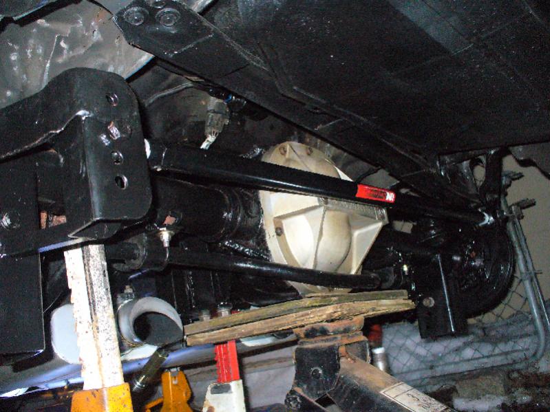

Re: Anyone using this panhard lowering bracket?
Im running one that i made on my ford 8.8. It cost me maybe 10$ for the steel. and i have 4 mounting holes for different ride heights used 2 support tubes instead of the 1 u get with the jegster. you can also see the LCA axle mounts I made so I have 5 mounting locations for my LCA's depending on how I want to drive the car (drag, street, autoX) and allows more adjustment for if the car is lowered. The LCA mounts I drilled the holes in an ARC so to change LCA position doesnt require changing the length of the LCA (UMI double rod end offset bushings) which makes changing the LCA angle a 7 min job.
BTW my car is dropped 1.5" front and rear.
