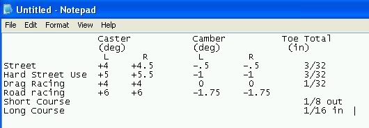

Re: Upper strut mount comparison
Here are the recommended settings for your alignment after getting the strut mounts. These are much better than the stock factory settings (+0.3° camber and +4.7° caster)
With Sportlines and better strut mounts, you should have no problem achieving these figures.
