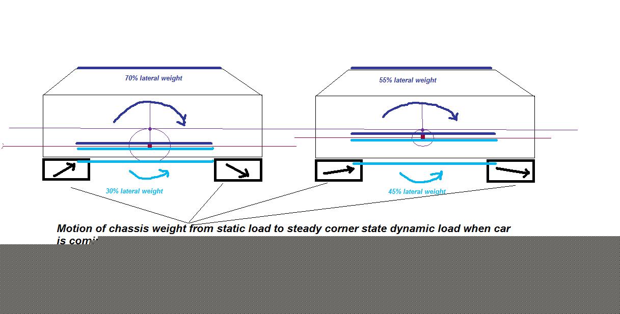

Re: The Grip
Hopefully this visual will help explain things better than words to alot of people who do not understand the roll centers and overall roll axis. You are looking at the car from the front and lets just pretend for ease of discussion that the front rc (roll center) ahd rear rc are exactly the same height off the ground. Thus the roll axis that is an imaginary line that connects the two is what the chassis rolls upon. The purple represents the lateral cg (center of gravity) of the chassis. The verticle purple line is like a breaker bar in leverage length whether above (positive) or below (negative) of the(red) rc (most all cars ar positive, and thus the need for a larger swaybar the more positive it is.)
Note that the more weight is underneath the rc, the more the lower weight resists the heavier upper roll weight when lateral centrifical force is applied+ thus smaller swaybars needed. As grip increases, the sway bars size goes up to control roll degree- it is all relative. So on a car with race tires, you need larger swaybars than a car with street tires because the overall roll will be greater even when the ra (roll axis) is not changed in height- UNLESS it is completely neutral or negative. Alot of open wheel cars do not run sway bars because they are so close to neutral. A little roll is good to promote suspesnion articlulation for camber gain.
Attached Thumbnails The Grip-lateral-load-contact-patch

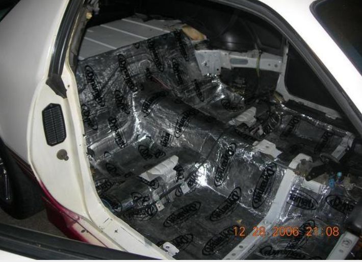

Noiw the next chassis trick we will steal the attachment from post 54 above and show how adding weight to it will change things for the better in roll weight bias.
Note how the simple addition of 70 lbs of Dynamat sould and heat absorbing material lined to the floorboard of the cockpit (keep it inside the axles for less polar weight)- so just the cockpit floorbard and under the rear seats-I put mine up the rear backrest also to add just a few more pounds of rear bias to the chassis weight- every little bit here and there all add up to help wih a 50/50 bias load on the front and rear axles. note the change in upper and lower roll weight percentages. Works towards a more neutral roll rate.
Note that the cg will come down very slightly- too little to show since 70 lbs of weigth added to a 2000 lbs chassis (sprung weight) is small in visual but the polar placement of the Dynamat from the CG is what is important to get it llow from the cg so it helps counter act the heavier upper positive roll weight. the chassis stays more flat in a corner- THUS keeping more weight on the inside tires.

15 years on TGO and I am finally giving up all my old secrets. I do not own a 3rd gen anymore but love them- so I guess its time to share.
Dean

You can visualize how more negative camber more inward lean of the strut angle) will lower the front rc. More angle of the a-arm will also lower the front rc.
More camber should decrease the length of the Front View Instant Center (FVIC). This moves the tire patch intersection line inboard with it and will actually slightly raise the roll center assuming the lower control arm is at the same angle.
The dynamat idea would be okay if you needed ballast, but for a street/track car w/o a minimum weight the higher weight will hurt more than help. You may have less % weight transfer with the weight down low, but the overall weight on the tires, both inside and outside will be higher, and with that lower grip. Even if the 70lbs of dynomat is at ground level, having no effect on overall weight transfer, you've put an estimated 20lbs more on each front tire, and 15 more each rear, regardless of lateral acceleration in a turn.
Horizontal RC migration with the more uneven roll shouldn't be a big issue. I think I've posted this link before, the roll center is nice statically, but in roll there are some myths: http://www.neohio-scca.org/comp_clin...namics2007.pdf

Now we will show how the geometry will change the front rc - the pivot point as which the front chassis weight rolls around. Weight above and below this counter act easchother. Morechassis weight above will increase roll (positive roll as explained in the graph several posts back).
I will re draw the A-arm angle on how it will change with an extended ball joint. Note that the car will lower the exact same distance of the extended ball joint (ie- a 1/2" longer ball joint will lower the front chassis 1/2", 1/4 will lower 1/4", etc.) This lowers the cg, but raises the rc and brings them both closer. rc is red, cg is purple.
Will the roll center be the same with drop spindles like racecrafts as you state here with extended ball joints? Thanks for sharing your expertise I am learning alot about how to setup 3d gens properly.
For a short answer- yes. Drop spindles are even better for geometry because they give you 2" of drop in CG without even changing the factory geometry. Then when you start lowering more in spring height, the car will go low enough without inverting the A-arm like happens without extended ball joints. Extended ball joints give you 1/2". spindles give you muich more with 2". Better way to go but more expensive and alot of guys are reporting problems with tierod clearance issues on the Racecraft spindles. I have not touched a set in person so that from me is second hand knowledge.

Originally Posted by TEDSgrad
If the only change from stock is wider tire, then it's easy to see that wider tire has more grip. For customers who don't mess with ride height, this is a no-brainer. Lowering Cg & raising fr RC give more grip for less cost (new wheels/tires vs spindle/spring). But the issue of grip selection in 16" makes the purchase of new wheels necessary. Who knows, manufacturers could come back into the 16" size (or they move up to 18" and leave 17"). It's hard enough to make good choices with manufacturers changing the landscape.
But, weight control is grip.
Lowering Cg and raising fr RC will help more than wider tires (street/track discussion), and unsprung weight comes in, too. All the chassis dynamics come into discussion for grip.
Drop spindle is best way to lower Cg and raise fr RC - but it limits wheel size
Ext Ball-joint doesn't lower Cg as much neither do they come close to raising fr RC as much - but they are a viable option and they allow for wider tire. If you're going to go 295 or above, then this is the option - . You get more grip, but at the cost of more roll movement, unsprung weight, cost, & longevity (ride comfort on street - pretty much track only at this width or above, IMO). But you come out ahead at this width.
If the choice is 275 or 245 (with better roll movement), then I have chosen the drop spindle. My local venue is a 4 mile lap and fast. It fits what I am trying to do. Since my brake pkg fits the 16x8, I can put used r rubber on those and run the 17's on the street.
Unfortunately the selection of 245-50-16 sized tires is dwindling and there are no signs of it going back in our favor. Actually the two manufacturers I talking to at last year's PRI mentioned that the 245-50-16 and 255-50-16 are two oddball sizes that will be phased out by every manufacturer in the next 2 to 4 years. 225-55-16 will work on 8" wheels, but gives up tread on the ground - there are just as many choices in that size as the 275-40-17.
You mention the 295, which is a good option in an 18" - it easily fits with the right BS all around. I did find that the 295-35-18 BFG KDW has the exact same tread width as a 275-40-17 Falken 615K, although that is just one comparison. Manufacturers are looking to get rid of the weirdo sizes and focus on the ones that either sell a lot or are on a lot of different cars. 18" wheels with a stock height 25.7" tire has too little sidewall for the people in the northern parts of the county with cratered roads and is probably going to be slower than the same width 17" equivalent around an autocross or road course.
