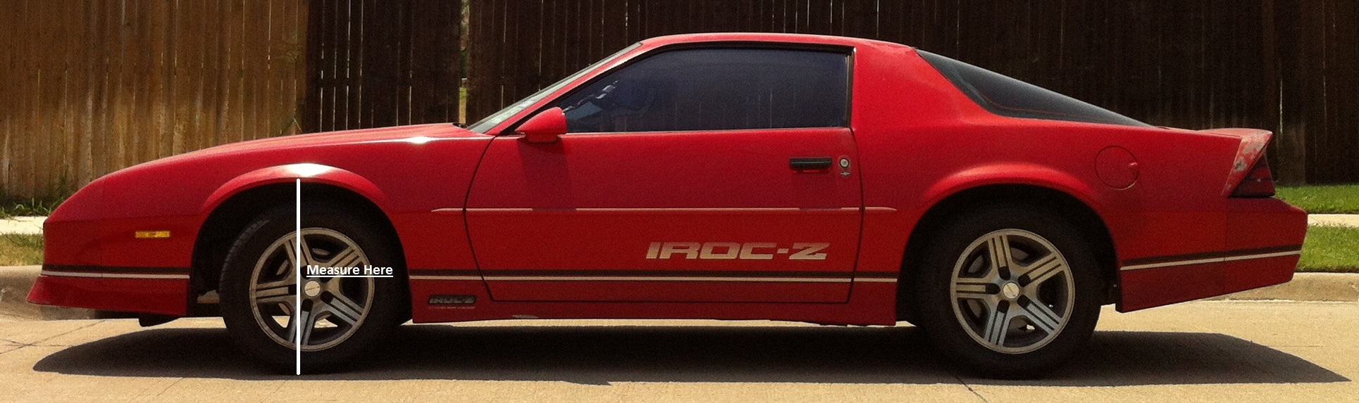

Have you measured the front ride height of your car? You should before you spend any $. To measure it you take a tape measure and measure from the front center fender lip to the center of the bottom of the tire.
Stock height in front is *around* 27.5 inches.
Believe it or not lowering springs will sometimes raise the ride height due to the stock springs sagging.
Could you post a picture, or give me the measurement of your front ride height?
Also, if your car still has it's spring isolators, then removing them will lower your car about half an inch all round. You would have to add some heater hose to the top coil to keep metal on metal contact at bay.
Here's a picture of where to measure: (My wheel is turned in this pic, but you get the idea)
