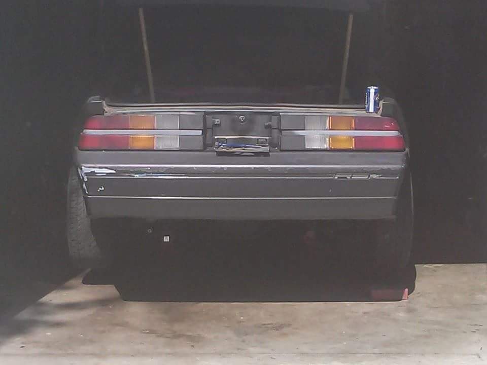

Ok...so what backspacing do I need so wheels don't stick out too far and want some width. Currently has 215/65/15

By any chance do you know the backspacing on 4th gen wheels?

pretty sure the oem 15" wheels are 7" wide and have a 3.5" backspacing, for a zero offset if that's the language you speak...
so look at the way your wheels fit in the wheelwell, and imagine a 2" taller tire that is about 4" wider centered in the same space in the wheelwell..
a quick google search found me this site that visually shows you the differences in your current and desired new tires and a good description of how it will fit:

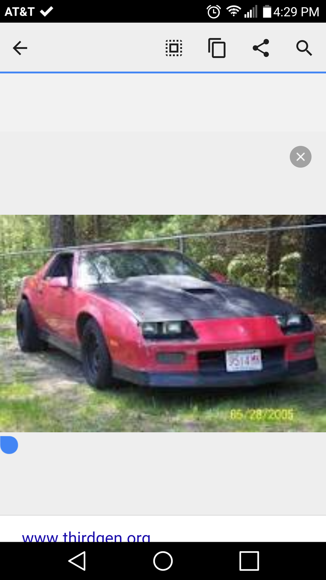

This is the stance i am ok with...i like the old muscle car look....

well mines got 245/45/17 i think it would look good with the offset on them. hopefully a meaner stance. ill have to keep an eye out for a 4th rear, than buy some decent brakes all the way around.

I had a situation with my 4th gen rear install that was not exactly bolt it. My rear axle came from an '01 SS with traction control. It had individual brake lines to each rear caliper. Fortunately I have a rear end out of a '99 v6 camaro that I used to own and shelled the spider gears in. I stole the distribution block from that one and bent new lines. THEN, it was bolt in.
