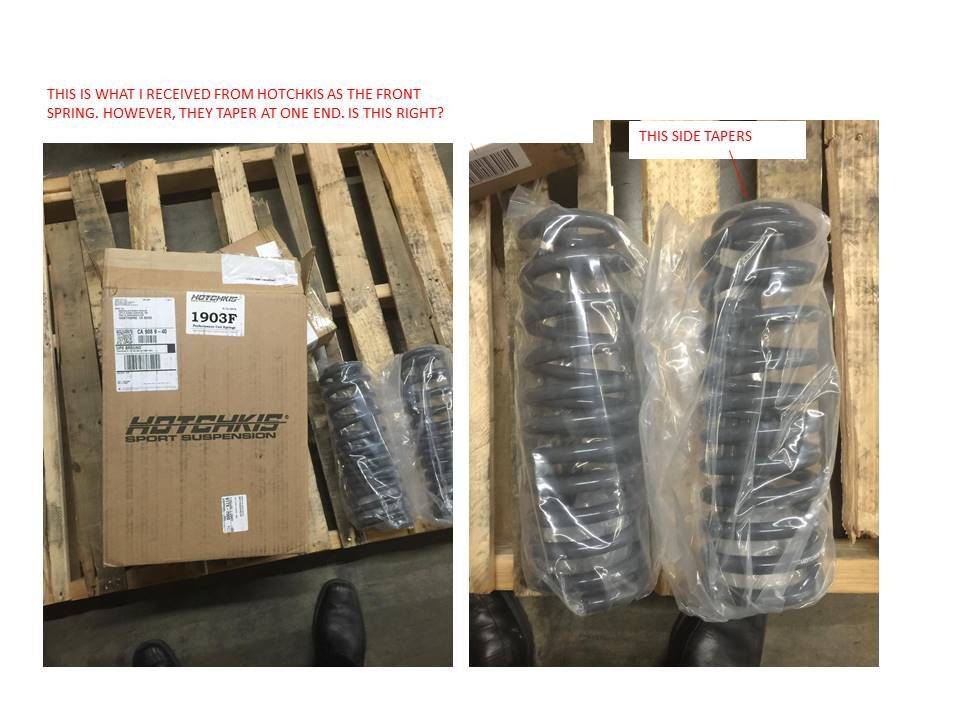

Hi Guys:
I purchased these 1903 Front Springs from Hotchkis. I showed them to my mechanic and he said they're the wrong ones and that the front springs are supposed to have the same diameter at the top and at the bottom, and if they taper, they're probably the rear springs. However, after sending them back to Hotchkis, they insisted they were the front springs. Does anybody know what's going on? Are these the front and if so, why do they taper? Can I still install them?
Thanks!
Simon

Did a google. Those are 1903R springs in a 1903F box.

Weird. And I have somebody from Hotchkis telling me they checked the part number on the springs themselves to verify. Thanks for the help!

No way there fronts for a 82-92 anyway.
http://www.hawksthirdgenparts.com/ca...op-spring-set/
two on the right in the pic are your fronts.

Got it. I guess the Hotchkis sales guy was just clueless. Thanks for the pic, that makes it crystal clear!
