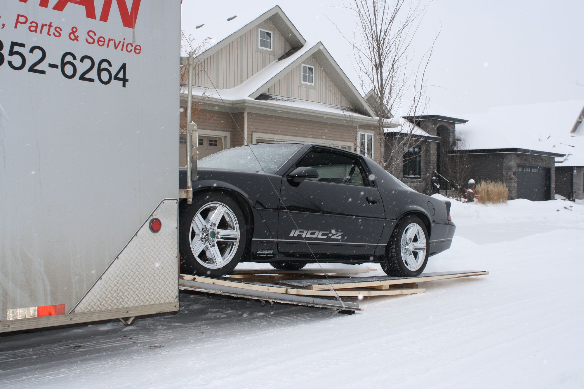

As it has been said before, spend the money and do it right, but be careful of how low you go. I love the look of a lowered car, but you do loose on drive-ability. I recently purchased a '87 Iroc that has been lowered. It was only lowered with spings, and I am assuming they are 2". The car was realligned to correct camber. It drives will with no vibrations or issues. However I only drove it on the test drive, and .8km since I got it home.
Old Feb 27, 2017 | 12:19 PM
Croz's Avatar
Joined: Jan 2017
Posts: 165
Re: Lowering, what else should I upgrade?
However, since I have the original springs I am considering putting it back to stock height. I know the Iroc's have a lower ride height then others from the factory, but here are some of the issues I have had to deal with....
1. To bring the car home in a trailer, I had to build a ridiculous ramp system with 2X10's. Even though the trailer had a ramp door and a beaver tail, the front air dam just barely cleared.
2. I can jack the rear diff up with a floor jack, but cannot get under the front K member. I have to drive the vehicle up on wood to get under it.
3. I cannot get the hoist arms under the stock exhaust and again, have to drive it up on wood to get clearance. Just be prepared some shops may not be able to work on your car if they have larger hoists or may refuse to work on it if it is a PITA.
4. The car will not clear any speed bump. The cat is the lowest point on the vehicle. Driveways and approaches will also be a challenge.
5. Even the previous owner said when driving the car he had to be 'thinking all the time".
I have 2.5" clearance to the front air dam and around 3" to the cat. Like I said, love the look, but if I end up being scared to drive it, it will go back to ride height. I included a few pics for your reference. Good luck with it and I hope it turns out exactly as you want.
