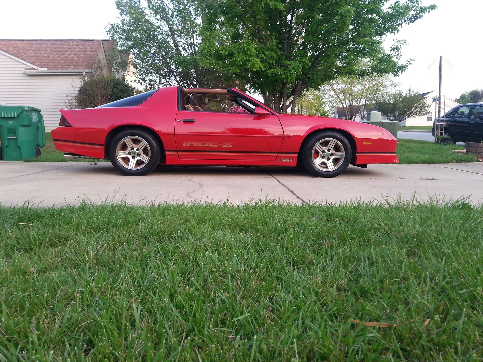

I put this in Suspension/Chassis, but it is very much a product/vendor review as well. Figured it'd reach more people here. ....I had lots of questions when I searched, some I had answered, some were answered by GC customer service, some I figured out on my own.
Vendor Review- Ground Control was great. Donovan took a good bit of time even before I was committed. Asked lots of questions about my car, and answered all of mine. Had a few email questions too, and they were answered promptly. I had also called another company selling weight jack kits for our cars and twice (on the phone) i felt as if my question were a burden, and they had better things to do. ....but all is well as my money went to Ground Control!!!!! They were awesome.
Product Review. Kit was well packaged well. Powder and ano is beautiful. Spanner wrench and allen key for set screw was included as well as "basic" instructions and a few decals. Front weight jack rod includes a grease fitting, and was lubed and ready to go when unboxed. Install was easy and the ride is MUCH better than my Eibach Pro-Kit.
Details. Guys, I took measurements of EVERYTHING, so hit me up if you have a specific question. Kit was for the 850# springs up front and 175# out back. Fronts are 9.5" (not 8") and are linear. GC said the 850's are 9.5" springs, and the stiffer springs are 8". (this came up a lot in other threads) Rears appeared to be NOT progressive as I expected. I think most thirdgen rears ARE progressive right??? These don't appear to be.
Obviously this isn't black and white as there are a gazillion variables, but here are my fender measurements. With the stock Eibach Prokit, fenders were at about 26.5" in front, and about 27.25" in the back. Knowing the GC kit was on deck, I cut the eibachs as last ditch "maybe it'll work" option. Had fenders at 25.5" and 26.25. Ride didn't change much, which is to say it was still "ok". Bottomed out, the GC kit was at about 25.375" and 25.5". ....I have it adjusted to 26" and 26.5", which to me is a good balance of looks, ride, and ground clearance.
Front adjustment was easy with the car on the ground. Lying on the ground, one hand on the tire for the leverage, the other on a 1/2" ratched with a 3" extension. (see pic) Very easy, just takes a little patience to pay attention and keep em even.
Rears I found were easiest to adjust by putting a jack under the SFC and jacking up 'til the spring was just a tad loose, then twisting the adjuster by hand. Didn't use the Spanner. Took too long.
Guys I have lots of pics and lots of measurement. Just lemme know if you specifically need something I didn't mention.

That last pic shows it at 26" to the fender lip up front, 26.5" out back. I'm sure they'll settle a little, but so far so good.
....almost forgot, -the ride is awesome!!!!!!!! ....I have the Eibach Prokit for over 10 years while it wasn't bad, it certainly wasn't as good as it could've been. These springs feel great! Technically rated higher than the Prokit, yet so much smoother. ...and they seem to handle just fine, although I haven't pushed them yet.

Hey Abubaca how does the ride height in the front treat you on the road? Gonna try to finally get the fronts jacks on my car this weekend and don't want to thrash my air dam.
Old Jun 6, 2017 | 07:11 AM
Abubaca's Avatar
Posts: 8,494
Likes: 411
From: Sophia, NC
Re: Ground Control Weight Jacks - My thoughts, details, specs...
I think it really depends on your roads. I'm at 25 7/8" at the front fender, and with good roads in this area,I don't ever really hit. I gotta take it slow out of my driveway, and certain shopping centers, but I can see it coming and I just pick my angle accordingly. Every now and then I'll scrape the air dam, but few and far between.

Old Jun 22, 2017 | 09:01 PM
Citation X's Avatar
Joined: May 2014
Posts: 340
From: Wichita Kansas
Car: 92 RS
Got the front weight jacks on and set to 26 in the front. I am pretty happy with how it rides and looks. I have yet to put on the struts and founders mounts so it should only get better.
Old Jun 23, 2017 | 11:07 AM
Abubaca's Avatar
Posts: 8,494
Likes: 411
From: Sophia, NC
Looks sharp!
Old Jun 23, 2017 | 03:51 PM
Citation X's Avatar
Joined: May 2014
Posts: 340
Car: 92 RS
Thank you.
