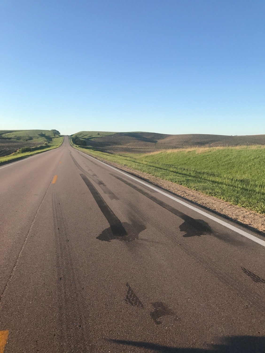

Did a little testing today, and it's painfully obvious I have zero traction like this
Here is what I have and what it's set on.
Umi adjustable tq arm -3* pinion angle
3.31 gear 8.8
Viking double adjustable rear shocks 6 clicks from full soft on rebound, 3 clicks from soft on compression
All stock springs with air bag in pass rear
28x10.50x15 pro bracket radial on a 10" wide wheel, 18#
Left on 12# on the trans brake. Probably going to be tough to hook that either way..... ported 243, lq4 with custom grind fti cam.
I used prep, 80% track bite, 20% denatured alcohol.
Burnout was 1-2 then rolled out, tires never smoked at all. Might be part of the issue.
Well I'm going to have to make some serious suspension changes :/
