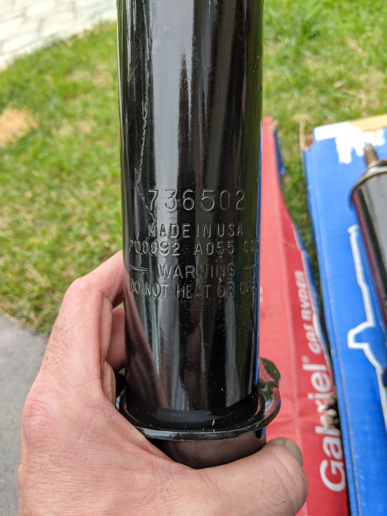

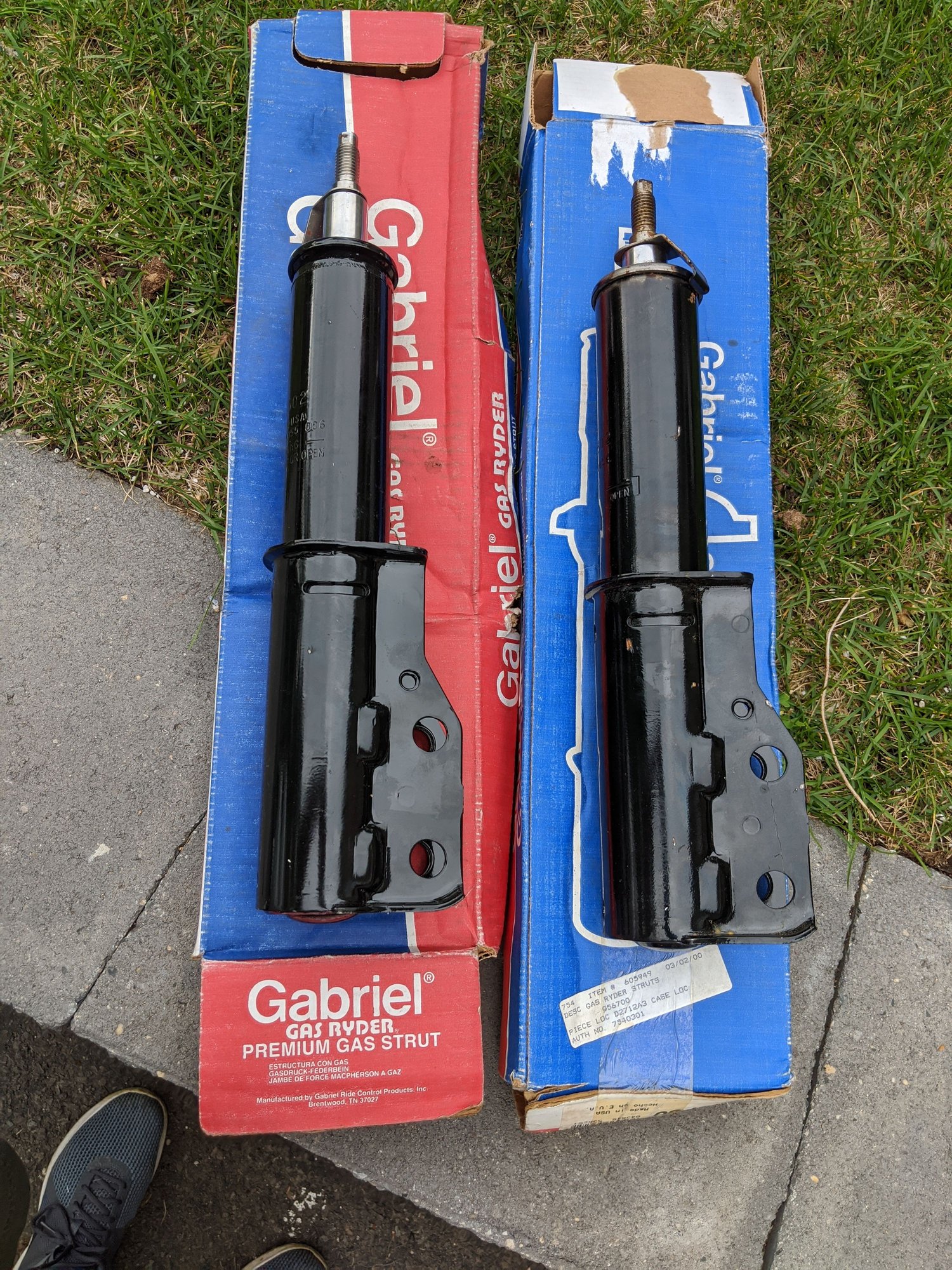

Not sure why I am even bothering, as Gabriel stuff is universally panned here, but... I have these struts that are approx. 20 years old... my father never got around to installing them.
Best to just throw them in the garbage and get a new pair of KYB's or something?
Car is stock, garage kept and not driven much, but def. needs new struts.
I'm kinda surprised that something"made in the USA" is so crappy.

Pop the hold downs off and see if they pop up to see if they still have a charge. Feel for resistance on the down stroke. better to test em before going threw all the install. my bet is the one the right is d.o.a.

"Made in the USA" is a dangerous slogan. You MIGHT get something good, as opposed to the cheeeeeeeepest thing some random 3rd world military camp slave can throw in a box, and the seller won't go to jail for fraud for mislabelling it; OTOH you MIGHT ALSO get something in a plant slapped together to make World War 2 materiel of some sort, that hasn't even had the floors mopped since 1946. Don't forget after all, the ENTIRE CIVILIZED WORLD (and some parts that it could be argued aren't, or weren't at the time anyway) was bombed back to the Stone Age then EXCEPT the US and certain parts of Russia, so everywhere else, all the factories are at least newer. "Made in the USA" is WWWWAAAAAAAAAAAAAYYYYYYYYY too eeeeeeeeezy of a slogan to abuse, to be reliable.

The one on the right has a shorter hold down on it. Not sure why it does, but that's why it is down further than the left one.
They do pop up and compress OK as far as I can tell

Shocks don't waar out from sitting in a compressed state. Unless they've lost their nitrogen charge, they are essentially brand-new...
