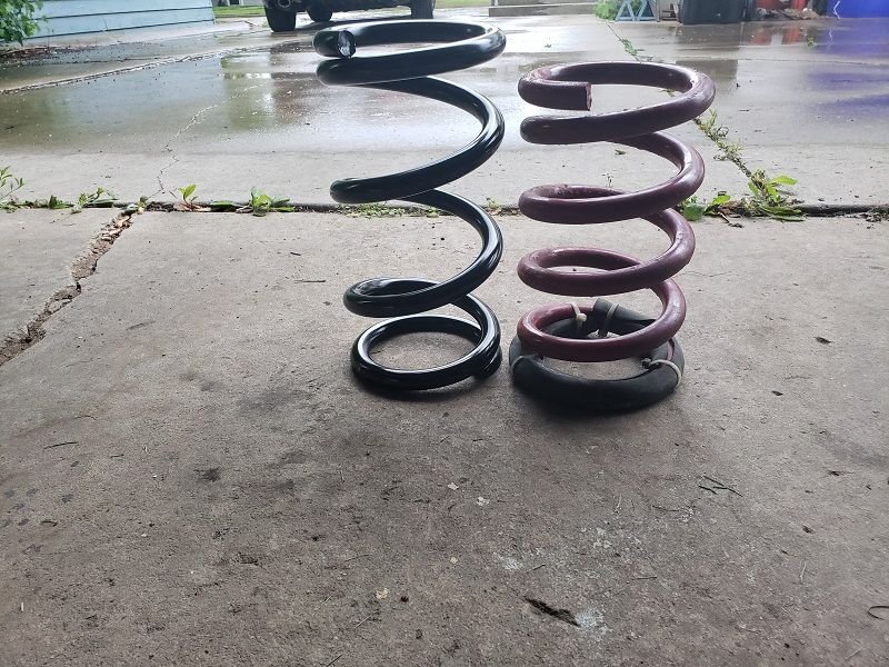

I think the #900 front is fine - that's what I have with drop spindles. Previously had 9" Eibach #850, but changed to 11" Hyperco #900 and saved #1 in weight savings.

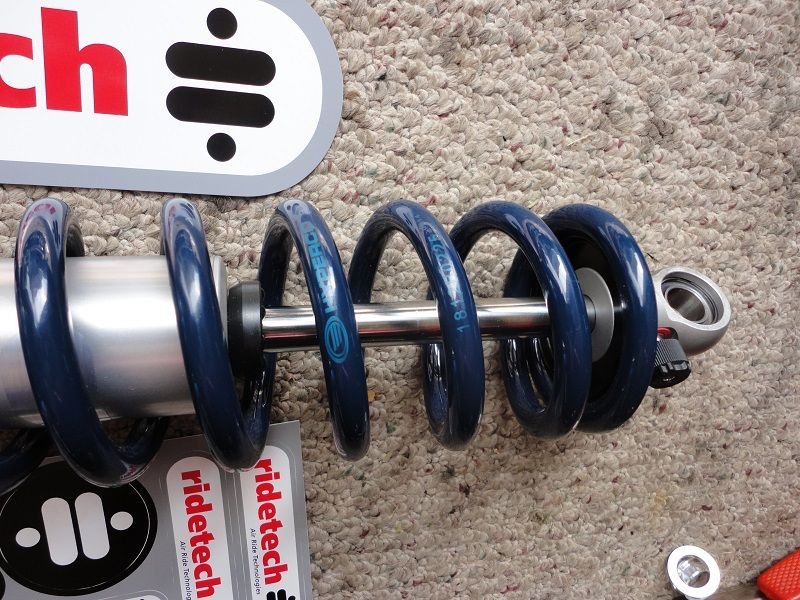

If you already have new rear Koni's, then OK. New tech in rear coilovers is better option and eliminates the addtl. cost of rear WJ's. Detroit Speed is good to watch, but pricey. They offer #275 for the rear with no mention of rear RC drop. An instructor I had, told me he was going to run #300 rear with no bar. I was skeptical, but sure enough, the heavier spring in back is an improvement. I have RideTech's with #250 and axle side PHB lowering bracket only and 19mm bar with 12 bolt..

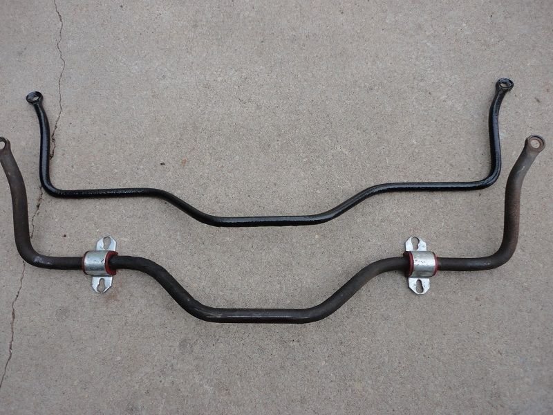

Detroit Speed
Stock 24mm vs 19mm
