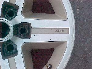

The 85-90 Iroc wheels will actually SAY front and rear...in small letters. I think 85-87 says it in the spoke, and the 88-90 you can see it between the spokes on the gold part by the center hub. Not sure about 91-92.
Either way, the rear wheels have a +16mm offset, front has 0mm. That means the fronts would stick out 16mm farther....or the rears would sit 16mm closer in. In this case, apparently causing contact with the tie rod.

91's also say on the wheels
