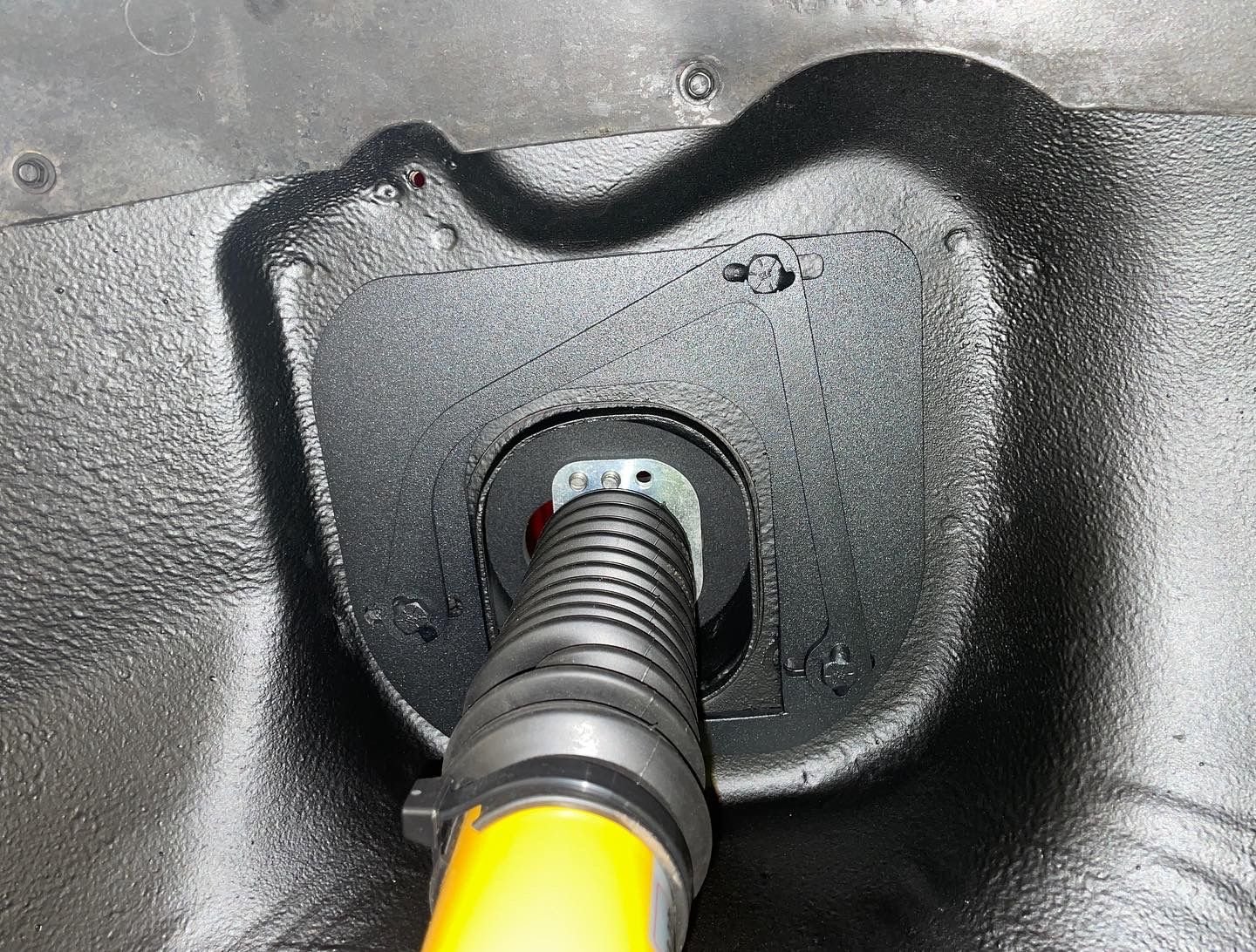

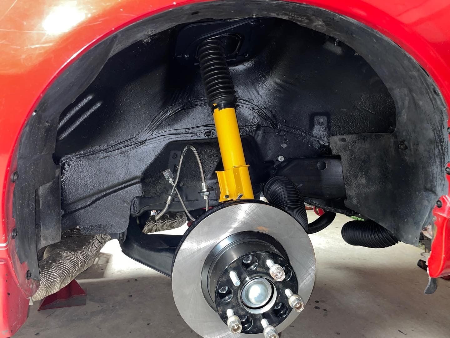

I used these on the KONI front struts, with what these things cost the shock boots hopefully will get me a little longer life on these struts.

Did you have to modify them?
I have some new Konis that I have yet to install...

The boots fit pretty snug over the strut body, the top close to the upper strut support I left it loose, the boot fitting snug over the strut body and a large tie wrap I felt was enough to hold it in place

Looks great. Do you know the part number? There are so many different ones on the Summit website...

https://www.summitracing.com/parts/ran-rs1952
