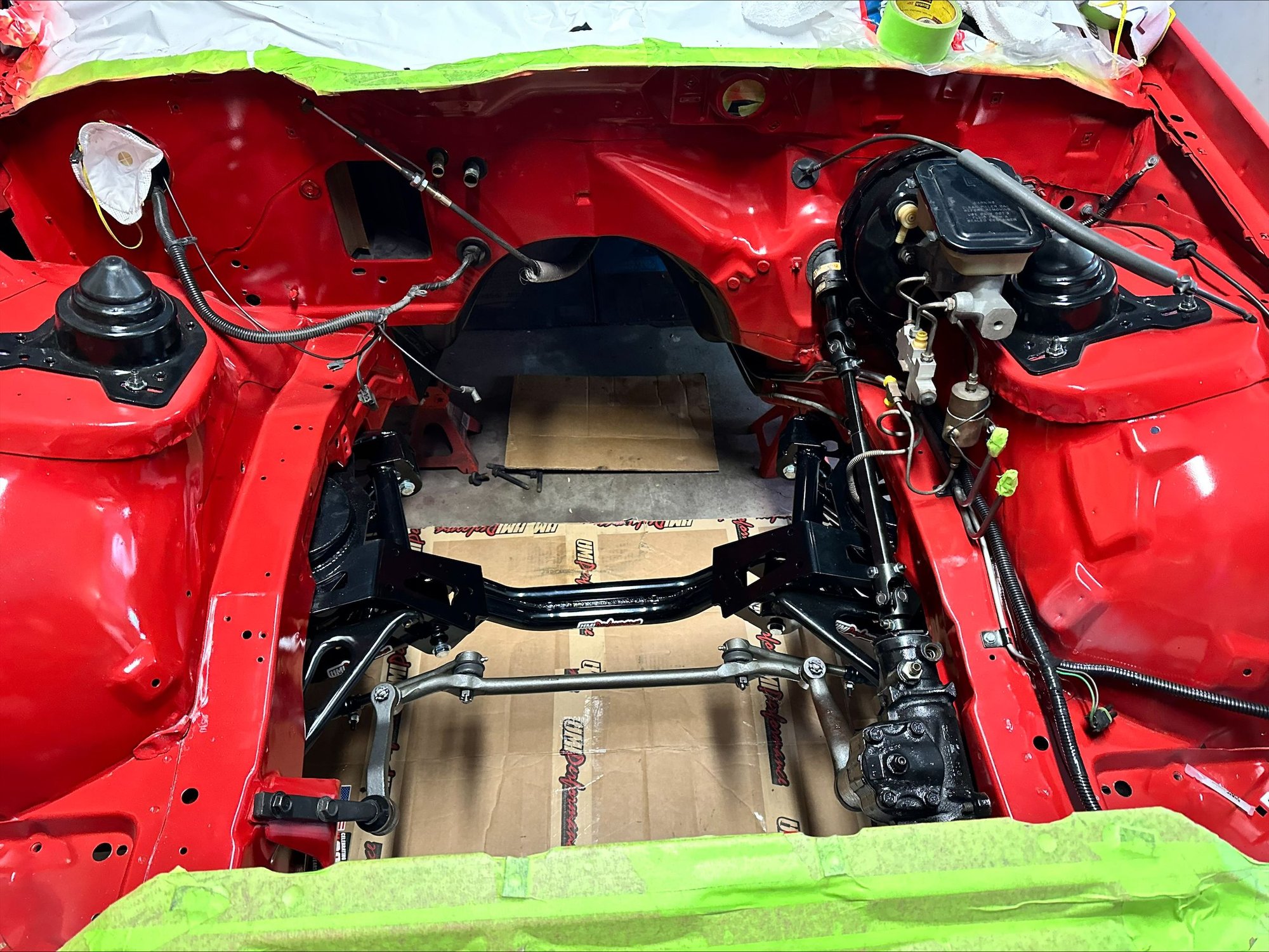

Thought I'd share here for those that wanted to save some money over the Hooker steering shaft, roughly $105 cheaper:
https://www.ebay.com/itm/386944230158
Here's how it looks in the car:
Here's my experience..
All of the hardware came loose out of the box, I backed it out, put some locktite on it and put better grease in the shaft itself.
The steering wheel side did not fit the shaft on the car. I had to use a small sand wheel to bore it out a bit. This took about 5 minutes and then it fit fine.
The steering box side, they suggest you flatten the spot where the stop bolt hits, but I ignored that part.. it already has splines, you just need the stop bolt to hold it from moving in and out. Loctite it and tighten it.. it won't go anywhere.
All in all.. once I bored the steering wheel side, it fit well.
My rag joint wasn't terrible, but it was definitely more loose than the solid shaft.
Overall I'm happy with my $100 saved.. now I'll put that towards some knock off rear hatch hinges. lol
