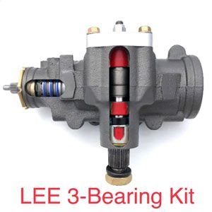

Recently I have been researching what LEE Steering Gears have to offer as a Replacement for our 12.7:1 800 Series Saginaw Steering Boxes.
They offer a 12.0:1 800 Series Saginaw Steering Gear Exchange with some Modifications and Upgrades available as well.
However they are definitely one of the more expensive Options at just over $1,000 as the base Price.
One of the Upgrades that I actually like is to replace the Original Single Needle Roller-Bearing and Single Bushing for the Sector-Shaft/ Pinion with Three different Design Needle Roller-Bearings and a Torrington-Bearing for the Sector-Shaft and Cover.
A Taller Billet Aluminum Cover is used with the New Bearing Configuration.
The placement of the 3 Needle Roller-Bearings are shown in Red in the Above Image.
This is an additional $225.00 Fee on top of the Base Price for the Steering Gear, which put the Cost Up towards one of the Most expensive Options for a Replacement Steering Gear.
