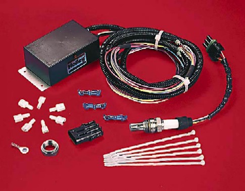

Closed loop kit:
Closed Loop kit:

There are a lot more parts here!
http://www.holley.com/HiOctn/ProdLin...IA/FMSFIA.html
This just gives you a general idea that Holley is serious about TBI.
On that page, you will see quite a bit more including the ECMS.

for your viewing pleasure..... check the link, but theyve even stopped making them.
http://www.turbocity.com/EFIDualDtail.htm

While Im waiting on a reply from them heres the harness they make to run a dual TBI set up maybe one of you can make heads or tales from it...
