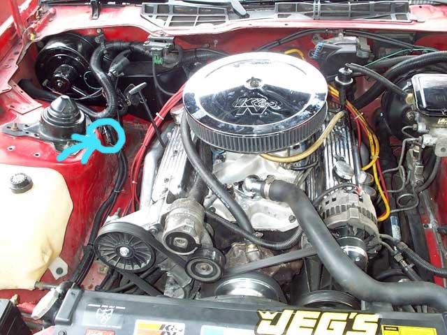

I need a pic of the wire that you disconnect to set the timeing on our car's

I don't have a pic right now but I might be able to do it later. It is brown with a black stripe on mine and it is located on the passenger side of the eng. bay.

Ok... I think I know what you are talking about... you have tried asking before and it is hard to figure out what people are telling you right?
Well, you are in luck. If you look at the pic, I have circled the area where the wire is located. It is usually pushed up under the big wire loom there. I'm assuming it is the same on a Camaro as it is on a bird. Actually, I think that little guy sticking out of the wire loom is the plug. But, all you do is reach back there and you will feel a little harness. Just get that out of there, and you are ready to start adjusting your timing.
