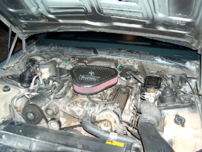

Well I FINALLY got a few pictures of the air cleaner, here it is:

Ok, I think I got it working now. Just disregard the very, very dirty engine bay

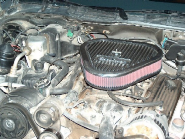

Number 2. Sorry if the pictures are fuzzy; im new to all this picture stuff

Looks nice man, and a steam-cleaning may be in order to compliment it
