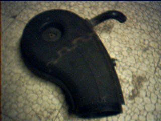

who provided the "bonnet" over the TB? i have a clearance issue. i need 1/4 inch clearance above the injector pod and i have about another 1/2 inch above the pod to the hood. i would like a cold air kit but could not find a combo that worked. i bought a TBI truck cold air kit but hood would not close. bonnet tto high. now i have a spacer on TB and a drop AC with a 14x 2 inch round AC. need to clear throttle arm on TB so the spacer needed. i think it is choking engine however my A/F is 13.5 on the WB? KN says flow insufficient for a 350 cid at 5700 rpms. only had a couple weeks to play with it. procharger has 3 diff height "bonnets" (2.00/2.75.3.75) but the $$$$ are too much. $180? that i could adapt to a vette SLP ram air system off ebay. thinking of a custom bonnet. it appears procharger uses a 3.75 inch dia inlet tube! maybe overkill? custom fab needed.
Posts: 9,962
From: Moorestown, NJ
Car: 88 Camaro SC
Engine: SFI'd 350
Transmission: TKO 500
Axle/Gears: 9-bolt w/ 3.23's
It was from, I think, superior airflow technologies. It was a closeout item so its no longer available now. They have aluminum ones like it but theyre expensive, and they have a partition in them which would be damn near impossible to cut out. With the resin/nylon one the two halves seperated so I was able to remove teh partition with a heated cutting tip.
thanks. i obtained the specific clearances from procharger. all i need to do is measure my existing setup and compare. it is more than a dome over TB. it directs the air up and over TB so that the path of air flow is verticle past the inj rather than sliding over edge of TB. odds are it wont fit anyway. i was lucky to find anything that will fit. tight squeeze.
