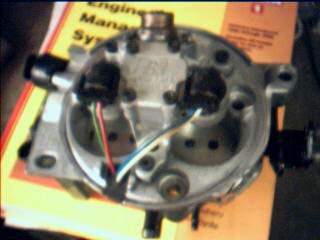

I got one of them off a cargo truck. THis is what it looks like after a few days of cuting and weilding. The injectors were filled with rust I never tested them or even tried to run them.

that tbi has the late model delphi injectors. They flow around 65 pph at the stock fuel pressure. Whats more interesting is what the hell is that appendage hanging off it? Some sort of cruise control? Electronic throttle?

I was thinking maybe a governor since it is in a truck. Many trucks atleast carbed ones had governors to keep the driver from overeving the engine in lower gears.

Yes it is a governor.
