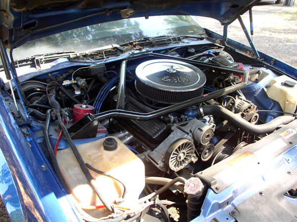

ive got a picuture might help might not

looks good but i need the rear of the engine

The MAP port should be a small hard plastic line, it runs to the firewall on the passanger side, the MAP is a black box attached to cowl on the firewall.
You can see it in this pictures, it is just to the right of the nitrous noid, basicly the black box between the nitrous noid, and the STB.
The other port I think you are talking about, goes into the intake manifold on the back runners??? if it is a large hose size, then that would go to your brake booster.
