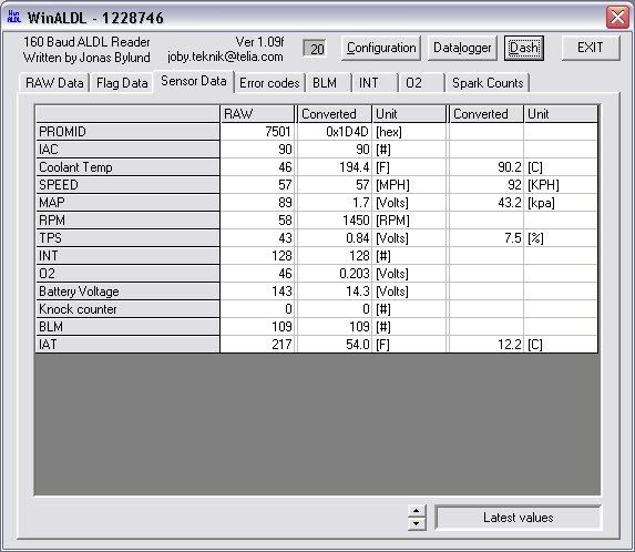

Okay. Finally got it started, and logged. I logged till the computer died, and then did some screen shots of the program. Im not sure how else to do this. If anybody needs more shots, or maybe I did it wrong, tell me. I kept getting a SES light while I was out. And there was bad detonation for some reason. Usually it doesnt do this. So, Here goes;
I screwed up the screen shots on a few, and forgot to get the raw sensor data. Im getting it now, and Ill post it asap.

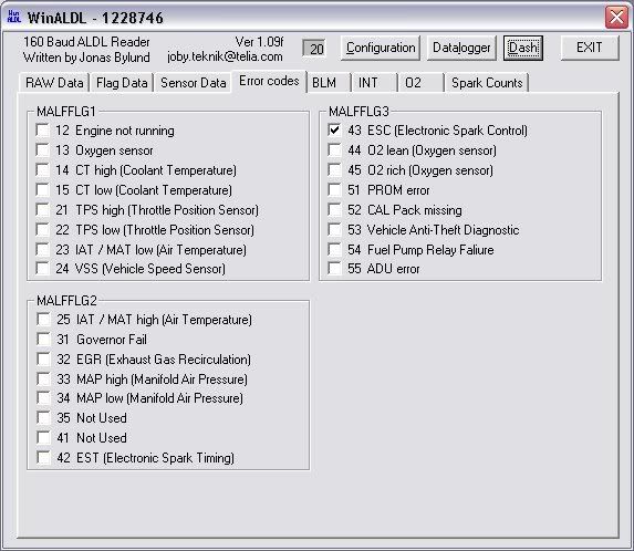

Well, Im a computer retard. I screwed up when I took the screen shots, and got two shots of the error codes, and none of the raw data. Ill do another log this week, and post it. Sorry.
And how does the data logger work? Its only ever showed one screen, with no way of going back to check earlier screens. Im assuming it replaces the information as it runs, correct? I drove for over 100 miles, and even drove till the laptop quit. How do I figure out what the SES light was from. Am I correct in thinking its from the ESC failure, on the failure code screen? How do I associate that failure with the raw data page, in real time, if it happened way before the last raw data screen?

I don't see anything wrong here, outside of the ESC ( knock sensor/module ) failure, and your comment about excessive knock. That explains the SES.
Look in the directory winaldl was running from, and see if you have a file with a name like
20080106_012345_LOG.txt
That would be your data log as long as it ran.

Ill have to break it up. It way to big. Evidently it was recording, but it went into hybernation. Here are the first 50 lines or so. If you need the other ones, let me know.
Edit: It doesnt want to keep it in a graph format, so Ill have to screenshot it, or try to upload it another way. Give me a few minutes.

Okay, here goes. Screen shots. And this is just the first few lines of over 230 lines. I didnt even get 10%.

As for the detonation, make sure that the ALDL cable does not have a 10K ohm resistor between pins A & B. If so it will put the ECM into diag mode which also adds timing. The added timing is to force knock for the tech checking the system out.

You find the test connector under the hood, and disconnect it. Then you set the timing according to the tag under the hood. That gets your base.
WinALDL will then let you know if there are areas at various RPM and MAP that still knock. To fix that, you start modifying the calibration data in the chip. Shortly after that, you become addicted, like many of us.
