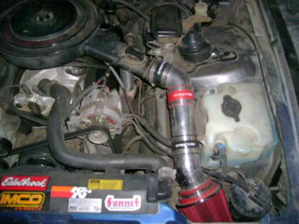

After I installed mine I noticed a slight increase in throttle response as well as a welcome sucking noise coming from the engine bay as well as a slight deepening of the exhaust note. As for the air temp sensor you can simply use your Dremel and cut a hole to stuff it in there and you're good to go. I plan on using my Ram Air hood to finish if off once I get the car painted.

Here is a start to my custom CAI. (Alaska has the benifit of being a little on the cold side!) I will be cutting a 3 1/4" hole to get the filter tucked behind the bumper then box it in somehow. Open Element Filter vs. Stock Air Filter???-intake.jpg

Originally Posted by akmusclecar
Here is a start to my custom CAI. (Alaska has the benifit of being a little on the cold side!) I will be cutting a 3 1/4" hole to get the filter tucked behind the bumper then box it in somehow. Attachment 167140
Should get that Caddy TBI hat and make that cold air look right lol. Just so weird, like eating rice and hamburgers at the same time.
