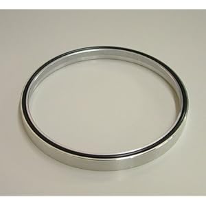

Its a little pricey but if your worried about the plastic spacer you could buy a quality part. = http://www.jegs.com/i/B%26amp%3BB/128/72250/10002/-1
Never saw that before, wow. And I went through 3-4 plastic ones. Well, now I know, although I don't need.

If you use a stock type housing, think about doing the power charger or salad bowl mod. The restriction in the system is the air has to flow down & around the injector instead of just flowing in from all sides. GM has the least restrictive tbi set ups, most other manufacturers have the injectors sunk deep into the bores, so not much room for improvement, unlike the GMs.

yup I had one of those for awhile. I do not think it'll clear a stock hood. I may be mistaken.
deffinately unshrouds the injectors some. I also cut out the bottom of the air cleaner.

The salad bowl and a 2" filter will clear the stock hood just fine. I personally use a 1" spacer and a 2x14" open element under a stock hood. The bowl with a 2" filter and a flat filter top might actually clear the stock hood as well, as long as you take out the stock aircleaner spacer. Not sure whether or not that fits with the throttle linkage

oh you deffinately take out the stock spacer with the "salad bowl" it clears the linkages fine.
