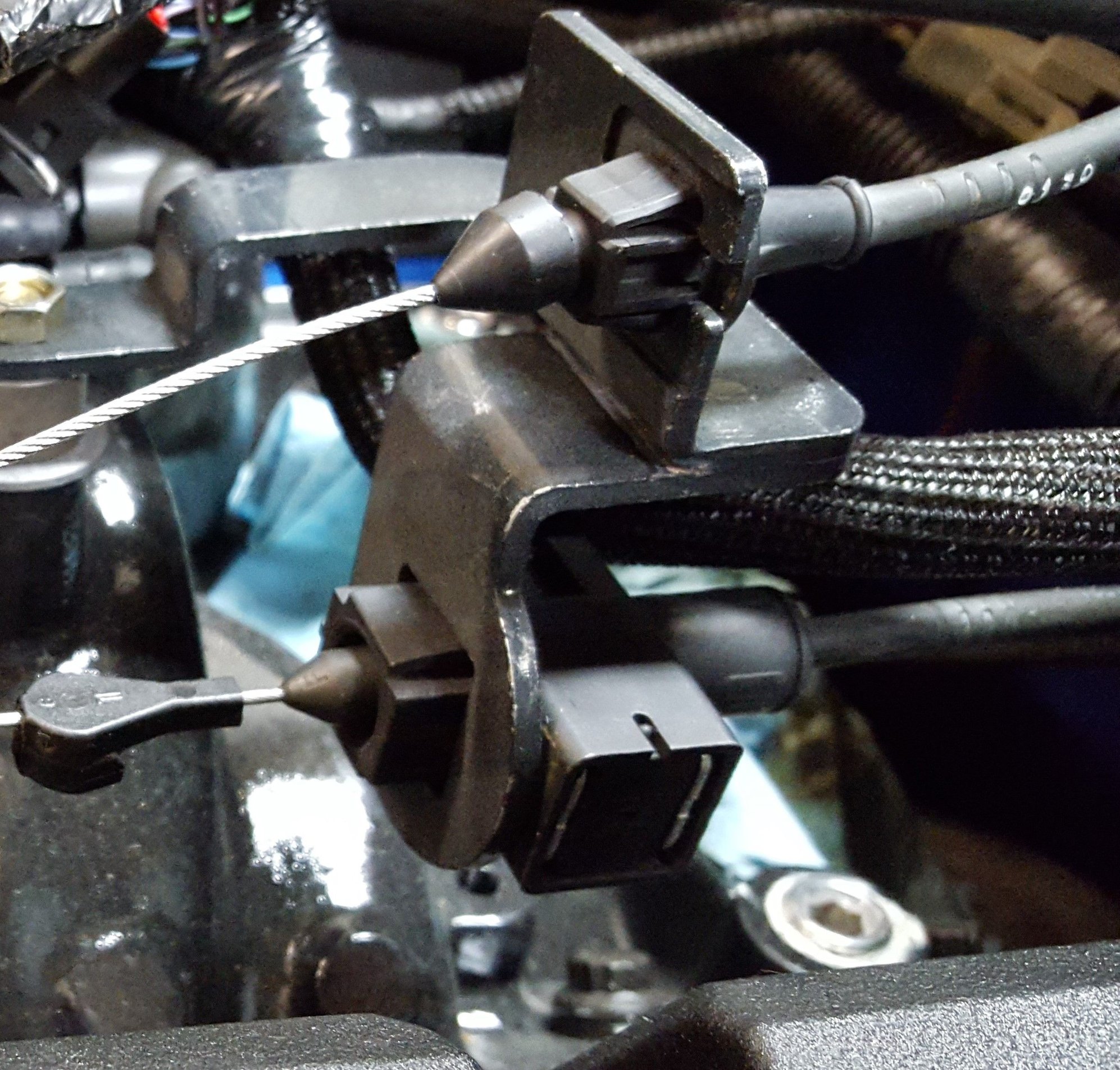

I finally put my throttle body on the engine today to mock up fuel lines and noticed two issues with my Throttle and TV cables. Since my car was originally TPI, my cables are long. It mounts up without a bind feel, but I'm wondering if anyone swapped out throttle or TV cables for a car with TBI instead of TPI or if you are just running the TPI cables without problems?
My second issue is that the TV cable isn't locking onto the bracket. On the Throttle cable, the bracket has a step that's thinner and lets that cable lock onto it, but my TV cable hole doesn't have that step and the metal is too thick for the tabs to lock onto the bracket. Did any of you have that problem?

I don't recall having that issue on dads Nova, it has a TV cable from a carbed 305/700r4 setup. I think I have the bracket in the garage somewhere from my kit I could take a look at. I didn't use it since I am running a t56.

Thanks, I've also noticed that the throttle cable won't directly connect because it has a barrel end on it. Looks like I can either buy a $15 TBI throttle cable or a $21 Lokar cable adapter. I had posted the same questions on the Holley site and Danny suggested modifying the bracket for the TV cable.

I think I would swap out for TBI or carb type cables instead of adapters and to get rid of the extra length. Eventually it will get in the way or end up kinking and cause you a headache.
