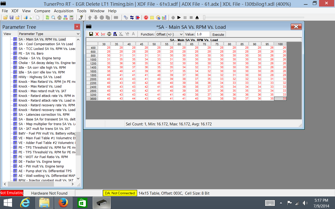

Okay, found a LT1 table online and adapted it to mine. The timing is way more than what the tbi had. Does this look right?
What controls the timing above 3600 RPM?

Old Jul 9, 2014 | 05:33 PM
  #172
RS-Chevy-SS's Avatar
Joined: Oct 2006
Posts: 829
From: California
Car: 1989 Chevy Camaro RS
Engine: L30 TBI 5.0L Vortec
Axle/Gears: Stock
Re: 305 TBI to 350 Vortec L31 Swap
Well first you aren't using the correct XDF file in tuner pro. You need to use the EBL xdf file. If your motor is anything like mine, then it will not like that much timing.
Old Jul 9, 2014 | 06:39 PM
  #173

Joined: Aug 2012
Posts: 466
From: TN
Car: 1990 Camaro RS
Engine: L31
I am not using ebl

  #174
Joined: Oct 2006
Posts: 829
From: California
Axle/Gears: Stock
I am not using ebl
Right. My fault haha. Still looks like a lot of timing. I would expect knock. Might be able to alleviate it with premium fuel and cooler ambient temps.

Spaceboy1980's Avatar
iTrader: (6)
Joined: Aug 2012
Posts: 466
From: TN
Car: 1990 Camaro RS
Engine: L31
I am also using a LT4 hot cam. Maybe I should start with the LT4 table?

  #176
Joined: Oct 2006
Posts: 829
From: California
Axle/Gears: Stock
I would start with the LT1 table and go from there. Run it real easy and look for knock. Adjust accordingly.

I have the tune as prepared as I can at the moment. I am getting some help in the DIY Prom forum. Trans should be done tomorrow and I will try to drop it in after work and button up the little stuff that is remaining.
Man that's a lot of timing from 2200-3600

I think that was the Fbody table, here is the Bbody that I am using instead:
Still a lot of timing but I guess vortec heads like it.
Not mine haha. However some like more than others.
