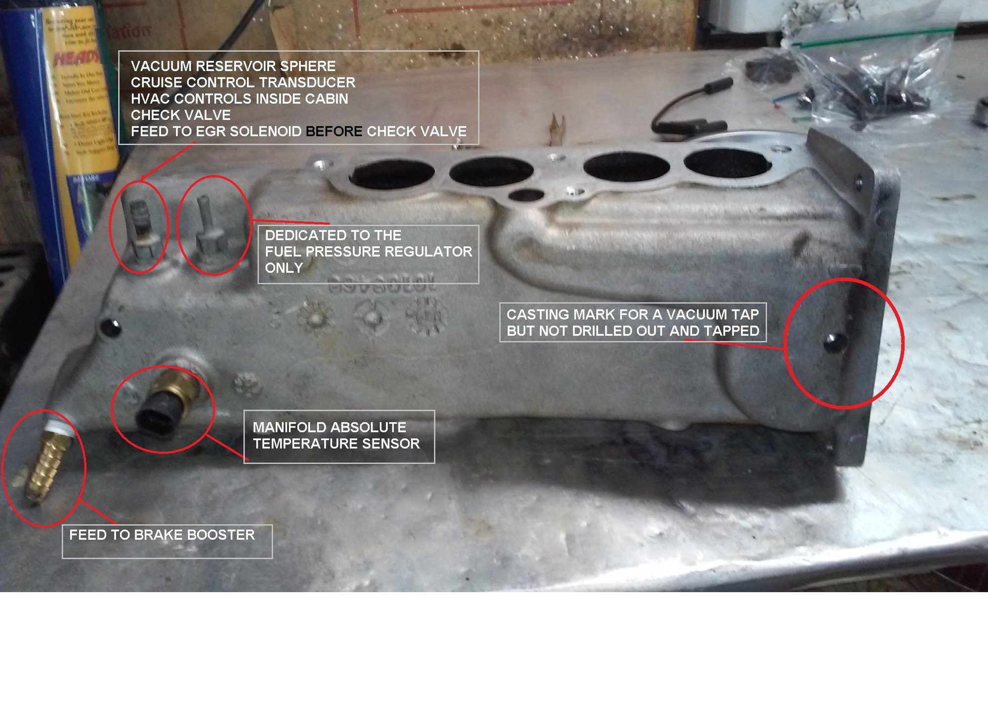

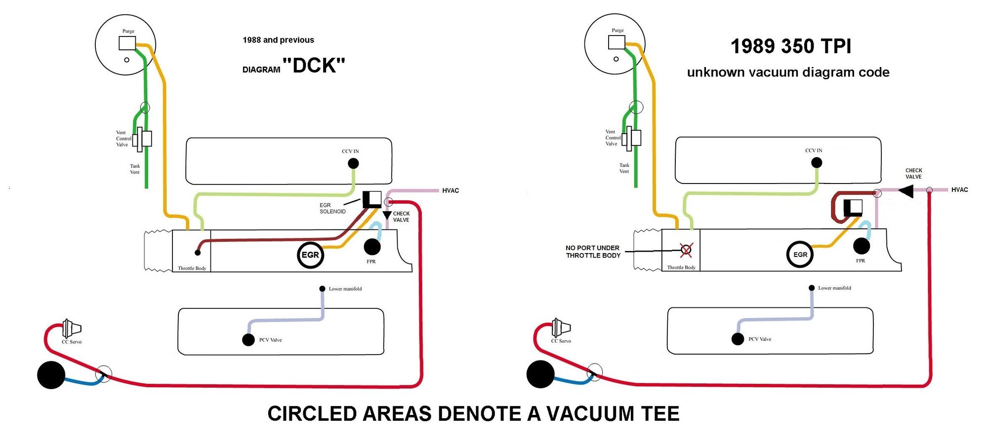

I decided to remove the plenum and runners to check the EGR and it's function. Here is what I have discovered. The EGR solenoid was opening and closing vacuum however it looked very rough. The casing had degraded and the coil windings were turning green. I decided to replace it with the 1994 Caddy upgrade I read about in similar threads. The EGR itself is intact. It holds vacuum and after removing and inspecting it is clear of any carbon deposits. The EGR temp switch had continuity at room temperature. If I'm not mistaken it is a normally open circuit. I have ordered a replacement. I will also be replacing ALL hard and soft vacuum lines as well as nipples. I did discover a crack in the hard line from the plenum to the FPR. After reading the shop manual in depth I discovered the EGR function was not being asked for from the ECM as my Park / Neutral switch was misaligned. I have corrected that as well. The car did not start in neutral which is why I suspected a problem. I am replacing the injector o-rings and plenum / runner gaskets upon reassembly. I am currently waiting for the EGR temp switch to arrive. A new o2 sensor is in the works also.
I also noticed a discrepancy in the vacuum diagram for 1989. The plenum does NOT have a vacuum tap in the front directly under the throttle body. I have modified the diagram to depict the routing I will take upon reassembly. I assume the EGR does not need a constant vacuum supply therefore it does not need a connection after the check valve but before it.
Please see the diagram and photos for the detail.
This is where I stand so far. I would appreciate comments from senior members with experience.
