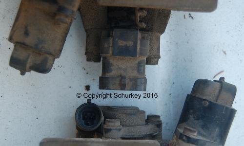

TBI TPS--three wires in-line, or three in a triangle/circular connector.
