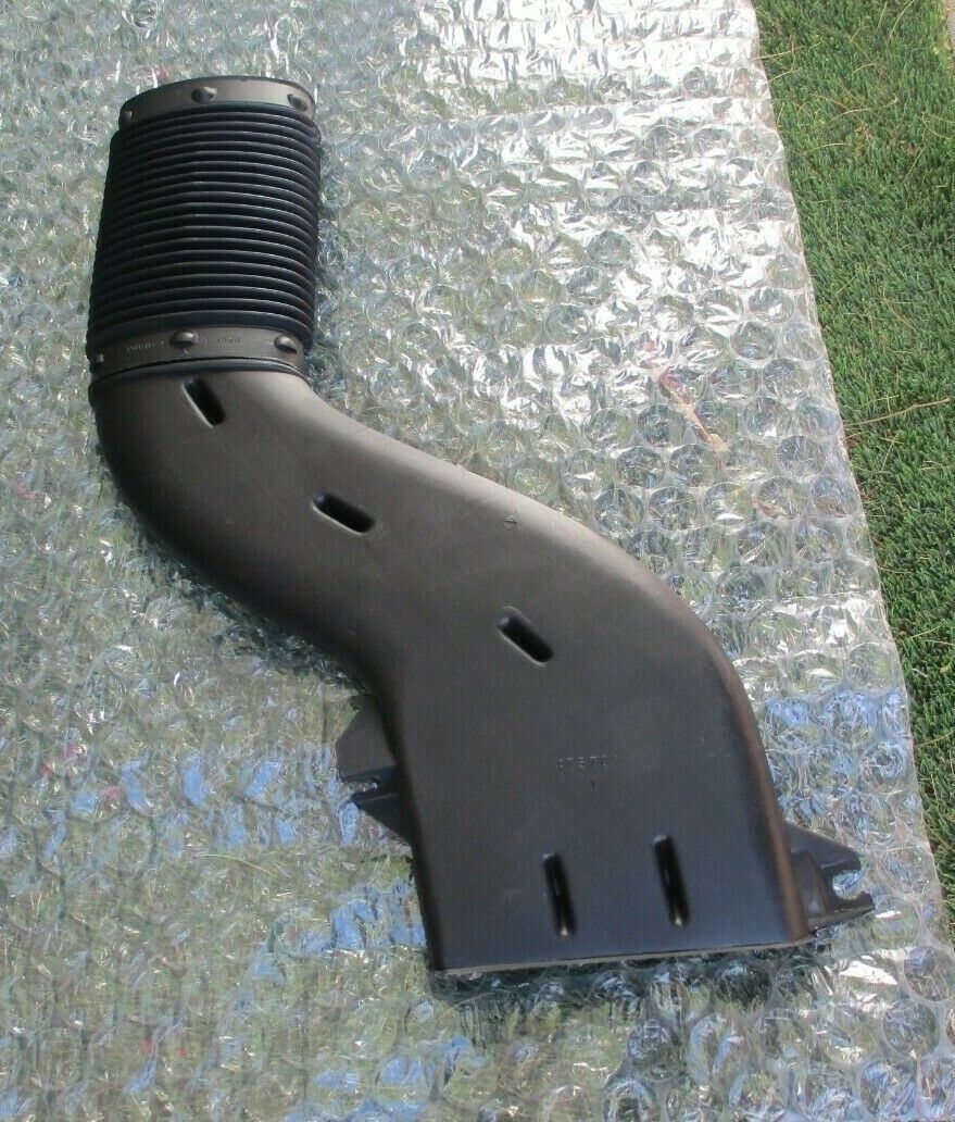

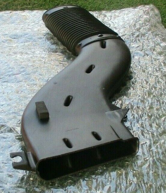

If you want to improve the air flow of the rest of the air induction system then look for some thing like this air cleaner setup off a 1977 to 1979 Chevy Caprice Classic with a 5.7L engine.
If you could find one of these and was crafty you could replace the snorkel, air duct, and air scoop going to the stock L03 TBI air cleaner base. Looks like it would flow better than the stock Firebird parts and seems low profile enough for the air scoop to fit on the Firebird's core support. If you was really lucky and found two of them you could probably make a dual snorkel air cleaner by flipping the air scoop upside down and doing them same thing on the passenger side.
Driver's side.
Upside down for passenger side.
And after all that work freeing up the intake air flow you would still have to replace the entire exhaust system starting with the cast iron TBI manifolds and everything all the way back to the exhaust tips because the stock TBI exhaust system SUCKS in through a straw and blows out through a straw.

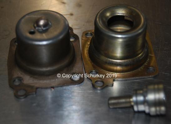

it looks like the stock fuel pressure regulator is adjustable, but just has a cap over the head of the screw. I think I will see if I can mod the spare one to be adjustable and get a fuel pressure gauge to see where the fuel pressure is really at.
There are several different styles, and they are adjustable. Until GM melts metal to make them "tamperproof".
Some guys have removed the melted metal to make them adjustable again. I've wrecked more than one trying to do that.
