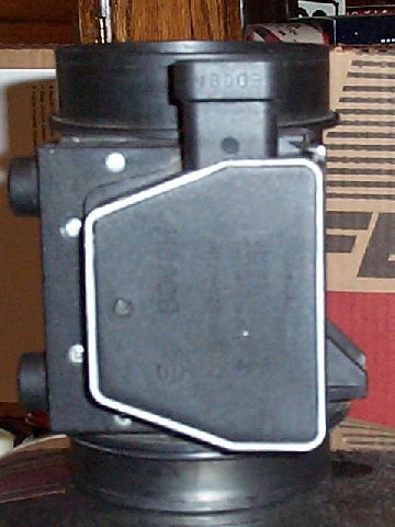

Thanks for your guys' quick replies! I will check the MAF tomorrow morning... I think it was replaced before because it's a Bosch piece now... just in case I will check it out. As for the throttle position sensor... your symptoms match mine also... all the way to the breaking. The codes read fine and everything. I reset it the same method as you mentioned... but I also wanted to remove the IAC because the car is pretty old... I just need to get a hold of a replacement gasket. Thanks for all the help!!! Keep the suggestions coming.

The original MAF was a Bosch part. There should also be a GM part number on the MAF housing.
