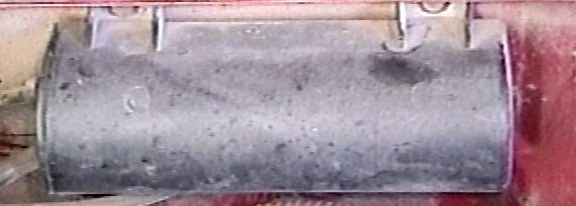

What is this thing?
It is the long black cylinder to the right of the wiper motor/washer pump assembly if you are looking from the front of the car. It has fittings for two vacumn lines coming out of the side, one on top of the other, but I only have the top line on it. I looked in my Haynes manual, but i could not find it in there.

Vacuum canister. It stores vacuum for the vacuum controlled stuff--like the A/C controls. Do your air conditioner controls work correctly? Top line to the A/C controls. Bottom line to a manifold vacuum source. I can't believe it took that many replies to get the answer, we must be slipping here at thirdgen.org.

Old May 26, 2002 | 02:18 PM
82camaro's Avatar
Joined: Nov 1999
Posts: 2,860
From: NE
Car: 82 camaro SC
A picture...

Yup, it's a vacuum tank. That design seems to only be on the earlier model cars (82-85?).
I've never seen it on cars with cruise control, so my guess is that that the vacuum "ball" that comes with the cruise control system also takes over the function of that vacuum tank. Later cars seem to have the vacuum "ball" in the fender regardless of whether they have cruise control or not.
I added cruise to my car a while ago, so I had both. I'm actually removing the small vacuum canister while I'm rewiring a bunch of things.
Yes, in fact, my climate controls are stuck on defrost, and that tank is missing the line from the bottom. So, where does the line go?
Manifold vacuum source... carb, intake manifold, plenum...

You need to run a vacuum line from hard manifold vacuum to the larger fitting on the canister. Find the line that goes through the fire wall. It's there, unless somebody has been seriously hacking your car. It comes through along with the HVAC wiring, which is behind the pass side head below the heater hoses. Once you've found it, run another hose from the smaller fitting on the canister to the one you just found. You vents may work a little better.
