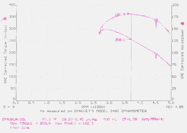

Hi.
I had my car dynoed the other day and was pretty stocked at the results. It got to max. hp. at around 3600 rpm.
The engine has had a basically stock rebuild, with a 210/220 dur. 480/480 lift at 112.
I have a 3" airfoil, open element breather (maf screens removed)
8mm taylors, busch plugs and tb-bypass.
The tranny has a stage 2 kit and 2200 stall.
Does someone know why the RPM would max so low? or why it would start dropping off so low?
My future mods include ingnition (needed, major spike at 4500), AFPR and headers.
Thanx in advance.

Sorry.
This is a 355 cu in.
The numbers are what I expected, just not so early.
