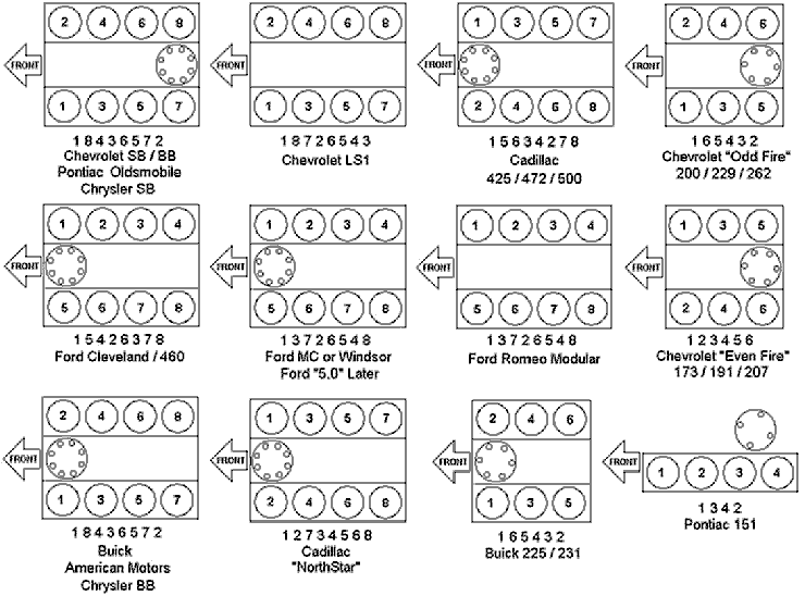

I am working on this 1988 camaro it has a 305/tbi auto. It came to me in pieces. I need to know what wires go where on the distributor cap. I'm lost thanks, brad

which wires? the spark wires? or the tach and coil wire?
If I remembr correctly, the firing order for a SBC is something like 18643572, but dont quote me on that..look in a chilton manual or something.
the number 1 plug location on the distributor will be 1 post past the center on the drivers side of the distributor cap.

the firing order is 18436572.

why don't you buy yourself a manual, if you'd listen to the first replys firing order you'd be screwed right now

here
