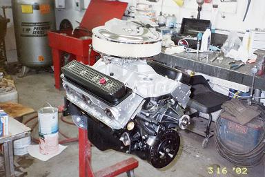

Well without going into it (just got home from Graveyard shift)
A HUGE DIFFERENCE
Attached Thumbnails How much difference will Vortecs make?-82-383-stand-small.jpg

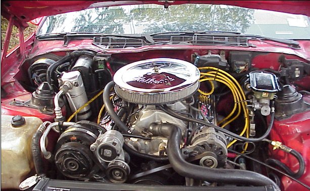

i belive vortecs design is not too good for high compression with pump gas because of there design, herd the design of the water passages or somthing like that makes the combustion chamber a little hotter and more **** to detonation. i think the vortecs are great heads over all and are very cheep and efficent. i love mine
