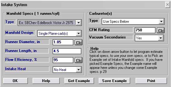

Been using it for over 3 years now, and it's good - a little pricey - but good.
Has lots of cams, head, & what nots in the database.
The image is a taste of the options in the program. The one thing that buged me with the DD2K was the total lack of intake options.
Ron

I wish EA was updated with newer intakes (like Super-VicJr) and that the fields did not get chopped off on some windows (like the valvetrain option). The manual should at the very least provide a complete descriptions of all fields. That way you know what is not being completely displayed.
