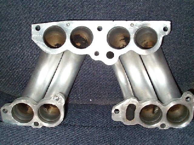

Matt,
You have to be very careful about the selection and orientation of the lower runner gaskets around the EGR and Cold Start distribution passages. They are similar and can be incorrectly installed or shift on installation.
