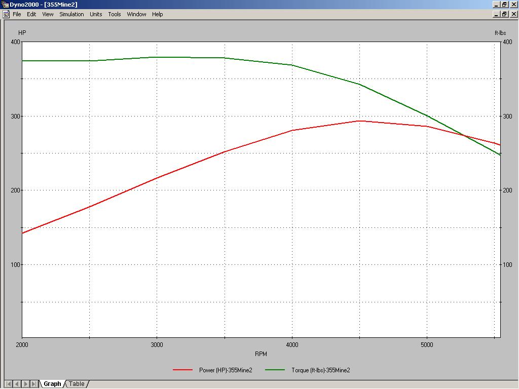

Can't get much flatter than this.
It's the Vortec heads with a stock LT1 cam, Small tube headers w/mufflers, 670 Carb, DP Intake, all at 9:1 comp. Pretty flat if ya ask me.

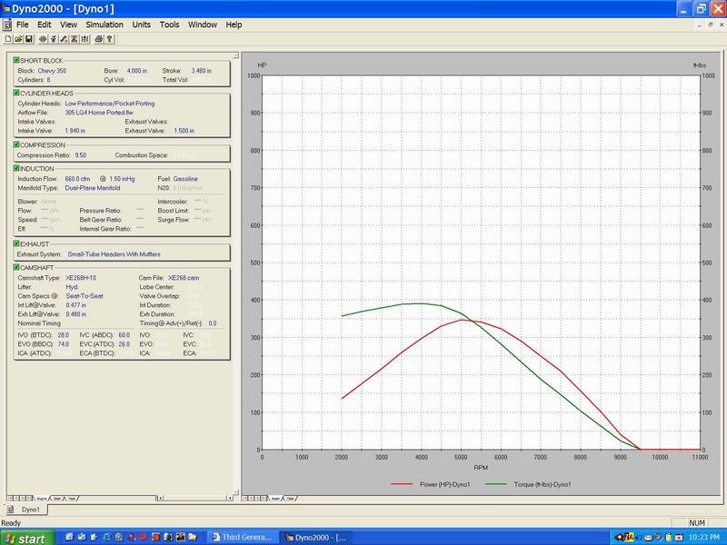

This is a mockup I did of Mark Shields' 350. It has excellent hp and torque. You can see most of the parts in the pic of the graph. It also uses a Weiand Stealth intake manifold and home ported 305 heads, which are almost the equal of Vortecs. You can find out how to do your own heads by following the link at the end of my sig

Both those graphs look great! Looks like I'll be doing something similar to Mark Sheilds being I already have LG4 heads. Thanks alot guys!

i'm amazed how much faith you guys put in DD2000, not that it isn't usefull in figureing out what parts work or don't work together, but i've built a lot of 500HP engines, according to DD2000 that ddin't quite live up to DD200s optimistic calculations, not that the engines were dogs or anything, but they sure weren't as high HP as the program figured.
In my experience, it is not so much a case of putting my faith in DD2000 as it is a matter of knowing the program's idiosyncracies and making compensation for them.
One of its problems is that it assigns a specific value, hp-wise, for all dual plane intake manifolds. This is simply insane. It uses numbers close to what one would achieve with a Weiand Stealth or Edelbrock Performer RPM. Thus if you are using a stock GM 4 bbl intake you should subtract, on a built 350, roughly 40 hp from its totals. Or, if using an Edelbrock Performer, subtract about 20 hp.
