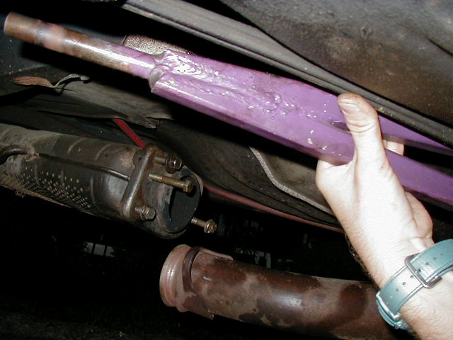

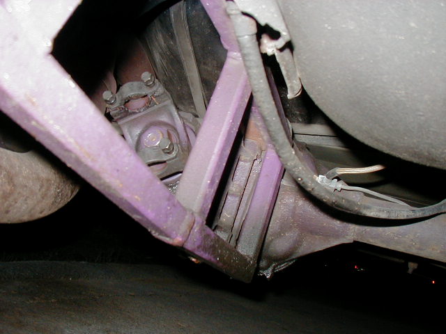

Built my own and it completly eliminated the wheelhop. I would recommond the Sphoon piece as an option

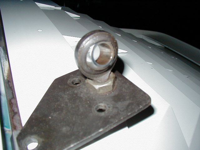

Here's the front mount (Tranny bracket) 3/4" rod end.
Old Sep 28, 2002 | 12:41 AM
JoelOl75's Avatar
Posts: 1,978
From: PA
Car: 88 Firebird WS6
