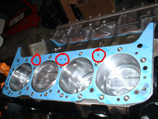

Okay, just finished up pulling off the intake manifold, only to find out that the gaskets were set correctly in the first place. It's a bit disappointing to know that I have to get new gaskets now and put it back together, but at least it's one less variable that I have to worry about.
I've gone ahead and posted a picture of what I found--obviously, everything looks good in there. Looking at the gaskets, however, did remind me of something. Look at the part of the intake gasket towards the firewall. Notice how that last port is largely blocked, with the exception of one smaller-than-a-holepunch sized hole. Now, on the intake mainfold, I know that that port doesn't actually flow anything (why, I don't know). But that reminded me of something that I thought was odd a few months back when I put the head gaskets on (also blue Felpros): between the cylinders, where the coolant ducts are, I ran into the exact same deal (one of those little holes instead of a hole cut out to the shape of the actual port). I think that *has* to impede coolant flow between the heads and the block--but I figured that FelPro knows what they're doing.
What's FelPro's rationale behind putting such small holes instead of actually cutting out a port there? Or did I put the wrong head gaskets on?

Here's what I'm talking about...
I fished up a picture of the head gasket before the engine was completely reassembeled.
The parts circled in red are what I'm talking about: beneath those tiny holes are coolant ports about 10x larger in diameter than the tiny holes in the gasket.
I'm wondering if mabye this might be why I'm overheating.

They put those holes in different places to regulate the relative amount of water flow to various points in the motor... that part of the engine on the intake side generates very little heat, and so needs little water; the hot part is on the exhaust side, especially at the center where the 2 exhaust ports are together. Note how there are 2 large holes over there.

RB83L69: That explanation about the head gaskets makes sense--actually pretty smart on FelPro's part. Although, interestingly enough, I can remember that the original GM gaket allowed for much more flow through those parts (the holes were the same size in the gasket as on the block/head).
