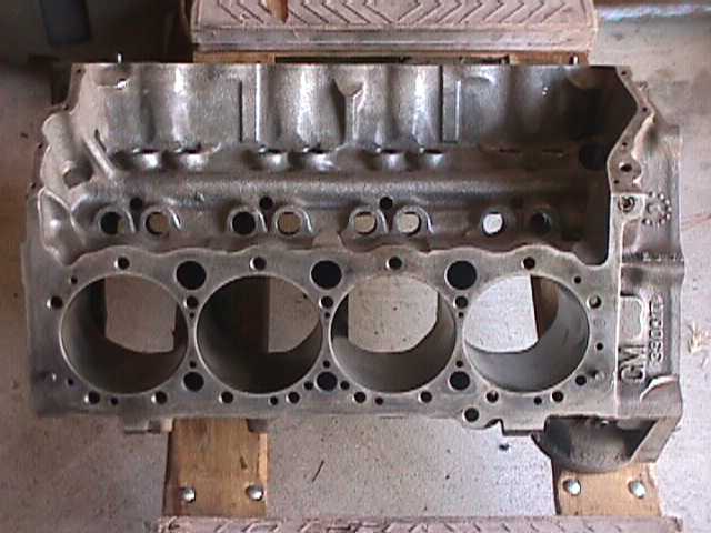

I see a lot of people degrading the SBC 400 because they dont have a clue what they are talking about. Before you open your mouth please do some research using the (scientific method) basic high school information. The 400 got a bad name because people thought they always over heated.... Shade-tree Mechanics did not compensate for the saimese twins cylinder. A 400 would out run any 350/383 withe the same internal parts. They will run just as cool if the steam holes were drilled in the block and proper cooling system setup. .. Dont just go by some hearsay that SBC 400 overheats. 75% of the reason you see all these 383 is because the 400 block is such a scarce resource. Im lucky I got a Standard 400 block fo $50.00.
Please know what you are talking about before posting such bad information, because somethings are best left unsaid....
Joined: Apr 2002
Posts: 1,136
From: Fayetteville, NC
Car: 84 Z28 Convertible 2 Seater
Engine: Dart Little-M SBC 400
Transmission: Pro-built Automatics 700R4
Axle/Gears: Strange Engineering 3:73
This is a HOT Item
SBC 400
4.125 bore- 3.750 Stroke= Plenty of volume to fill
SBC 400
